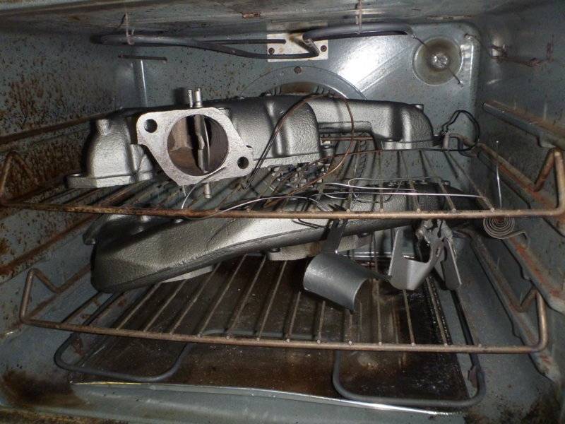

Saved my old oven great for curing paint. Painted a pair of wheels after they dried. heated oven to 250*. Put one in waited 20 mins turned oven off. Came n2xt removed wheel then did second one. Paint was like in was on for years.
...genius! .....no Toll House though, right?
.....question. Do you bake while working on the car? Love that oven in the last pic, hehe.
YES !
