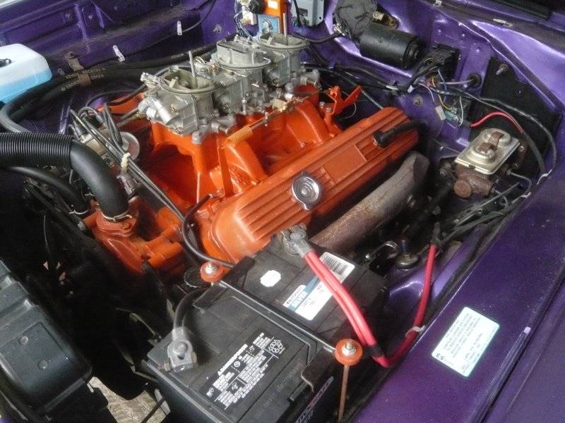

Bought the Bee about 5 years ago. I think chevy guys restored it. Got about 95% correct. So many things wrong. No fender tag/ build sheet. I have manual brakes with discs up front and drums on back. I believe they are 11 inch drums. Should the lines to the MC be on the fender side or engine side. thanks Dave

Not to be pedantic, but I think your positive battery cable should be routed along the fender and on the outer side of the master cylinder.
What disc do you have on front? OEM correct would have been KH single caliper with 10.98" rotors. Factory installed would have had 10" rear drum vice 11". Power Bendix with the Bendix disc MC with outlet towards engine for all but Hemi.
Wayne you forgot to point out Im missing the wire clip above the MC :lol:

Bought the Bee about 5 years ago. I think chevy guys restored it. Got about 95% correct. So many things wrong. No fender tag/ build sheet. I have manual brakes with discs up front and drums on back. I believe they are 11 inch drums. Should the lines to the MC be on the fender side or engine side. thanks DaveView attachment 1479596
