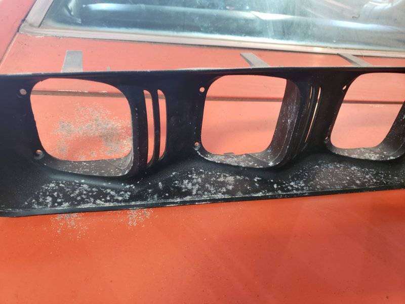

I soda blasted mine and then masked and painted.

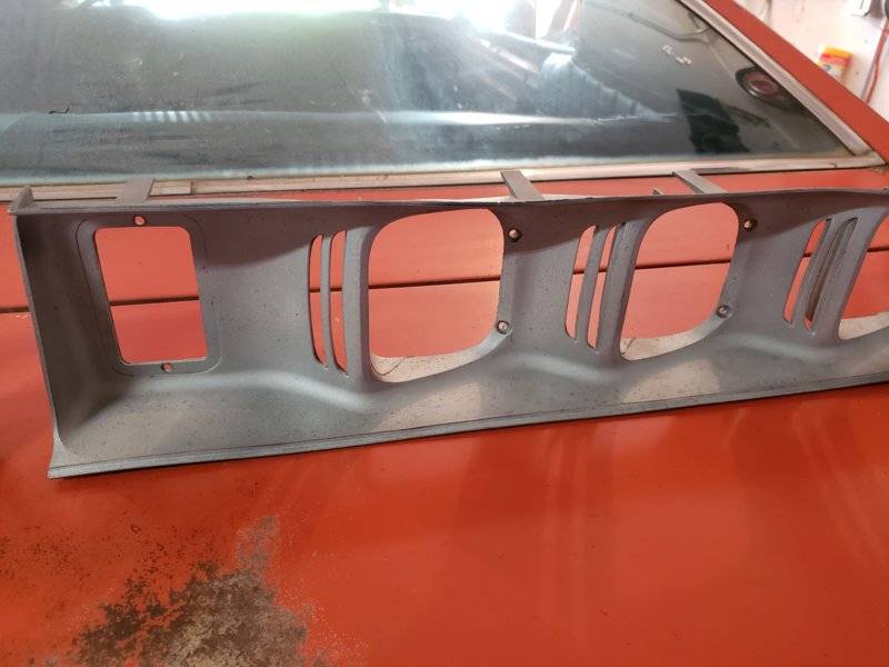

I used my blast cabinet on mine. Black beauty. My air supply isn't very good, so I couldn't tell you what pressure it was. Mine was pitted pretty good, I think they came out ok.

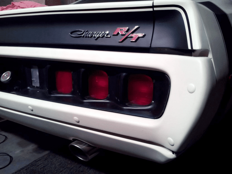

I used air craft paint stripper in a can. took the old paint right off. then duplicolor semi gloss black. it was pretty dark in the garage for this pic

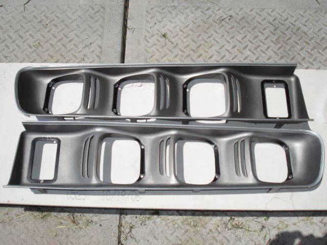

I painted these two bezels two weeks apart and somewhere along the line I mixed up the finishing paint.
I think the top is Eastwood's Detail Gray, and the bottom is Spray Gray; I went with the Spray Gray.

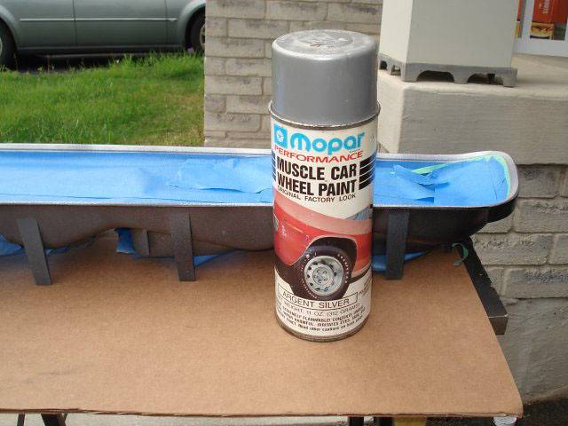

Used some argent I had kicking around for the outer part of the bezel:

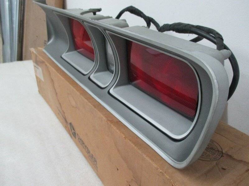

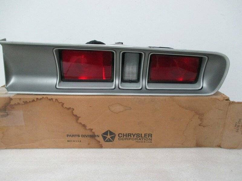

I believe the top has a more correct original look. Here's a picture of an NOS piece
Ron
I sold once 4 NOS R/T louvers and to me the correct gray shade is in the middle of both HOWEVER, pics can lie due the light and angle. Just side by side in person you can see the reallity. but on pics I like more the darker, not because correctness but my taste. The darker gray also makes looks better the lighter outline
