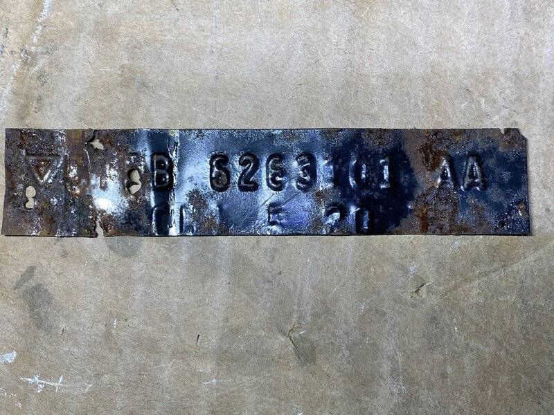

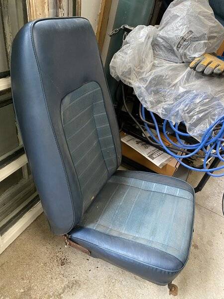

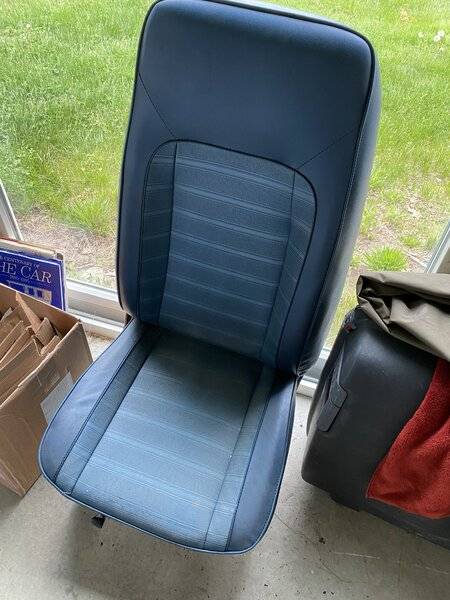

Hi folks, hoping you can help me identify these bucket seats for me. They came in an old VW bus I bought last year.
I currently don't own a Mopar but used to have a 1969 Dodge Polara 500 Convertible in the late 1980's and early 1990's. It was a neighbors car back in my home state of Wisconsin, pretty original but needed a bunch of work. My father and I got it restored and I drove it in high school.
Anyway, my assumption is that they are Mopar or for a Dodge Van? I took off the ID tag off the back of one of them
Thanks - Nate
