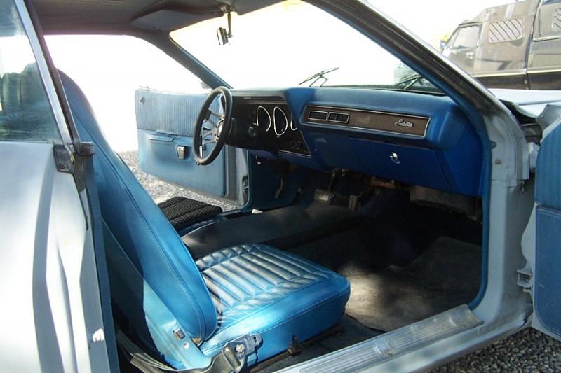

Both my 71 and 72 SSP's have thier original buckets. Same covers. Same foam other than my 71 is an early car with the foam molded into the frame. Same seat other than my 71 has 3-piece backs and 72 1-piece.
Here is my 72. Original tracks, frames and foams. Covers are from my buddies 71 RR and are the same as what came on it. Like I said, I have several sets of these, like 7 or 8 sets right now and have sold around another 5 sets.
