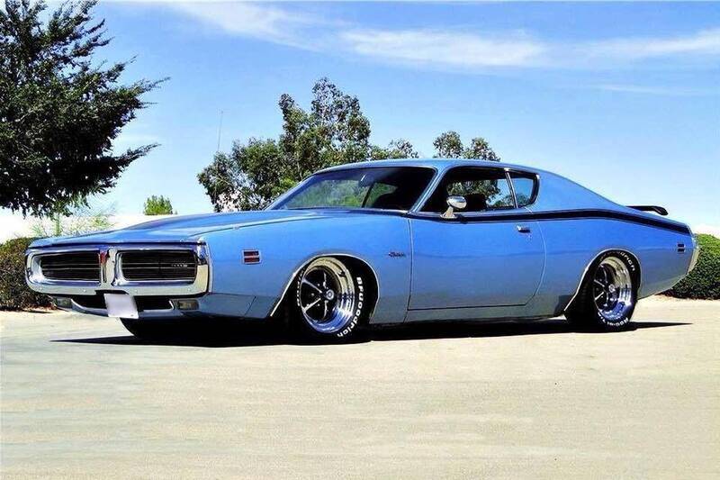

I plan to keep the patina of the car and make it a ratty, mechanically sound build with either some steel wheels with hub cabs or 17 inch magnums.

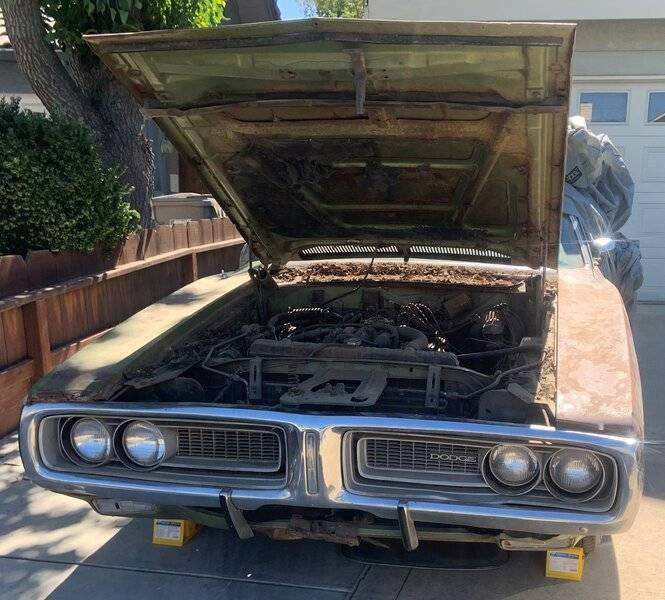

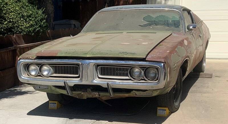

Here are pictures of my 71 Charger:

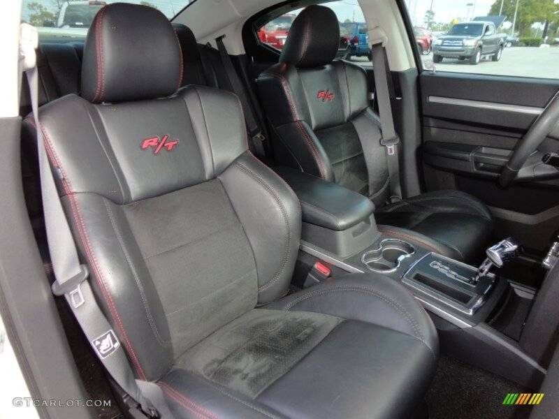

Some potential seats I would like to put in my car (2009 Charger RT) (also, I would like to use the back seats if possible):
Drivetrain is doable, if your keeping the stock suspension the torsion bar crossmember will need to be reinforced if your going to install a bigger transmission...
Seats you'll find they are designed for a taller cabin... Or in other words bolted to the floor your head will be in the roof, you'll need to lower the floor.... There are plenty of modern seats that work, the late model Mopar seats aren't a great choice...

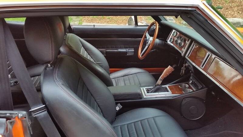

I have those seats on my 70 challenger. I used the rear seat overs from the new car and had them installed on the old car seats
I like them
here’s a pic to maybe give you some ideas. I saw that and liked it
View attachment 1137975 View attachment 1137976
Humm learn more that is not a 72 or 73.

Also by the time you get and pay for Challenger seats for similar you may as well have spent the money on Originals!
