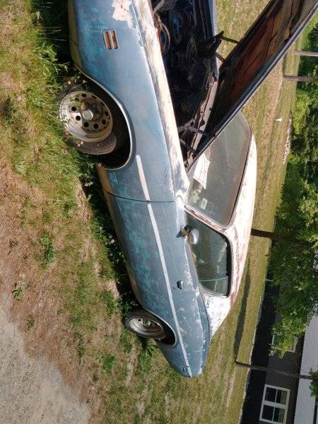

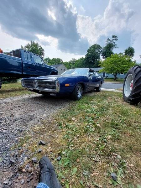

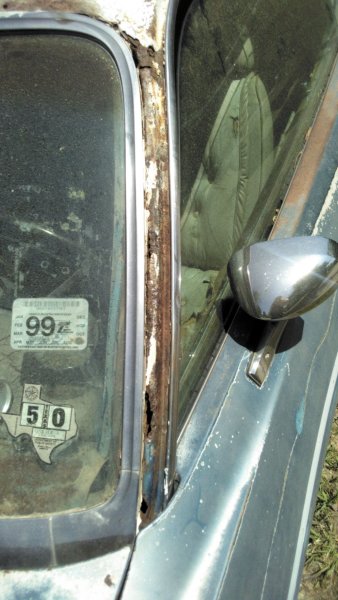

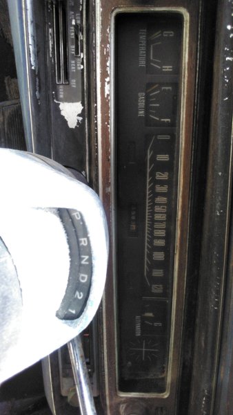

A gentleman and his son, not far from me, bring cars up from Texas now and then, don't list them for sale, just put one in the yard with a sign now and then. I drove by a few times before stopping to look at a 1971 charger, 318, column shift automatic. From Texas, so paint is pretty well gone, interior crazy brittle. Vinyl top off as well. Seats from something distinctly non-mopar, I'm guessing. Rust is limited to a-pillars and driver's toe box on floor pan. Undercarriage, trunk, remainder of floor is amazingly clean. 318 rebuilt to stock as well as brake system. Runs and drives excellent.

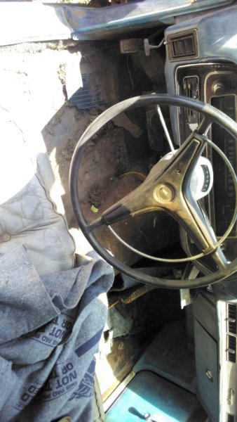

Well, I fell in love with this (not going to sell this one!) and bought it. Clean Michigan title in hand. Here's a few pictures of it in as-found condition. A-pillars are going to be fixed next weekend as well as the floor pan. Original carpet and under padding, which pretty well had disintegrated, was removed I'm the last couple of days as well as the non-original front seats (split bench, held in with two bolt apiece), and the matching rear seat (held on with bubblegum and a prayer).

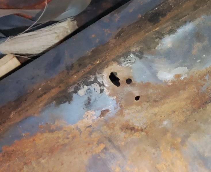

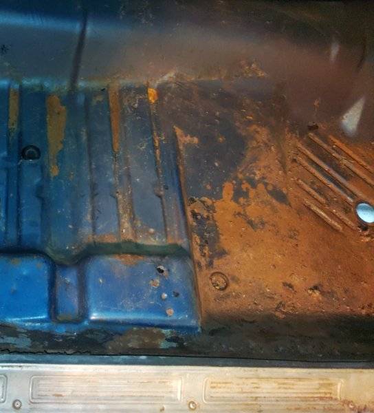

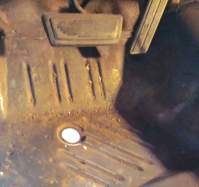

Floor pan in really in nice shape. Wish the foot area didn't have rust/pinholes. Cleaned it with angle grinder and wire wheel and it felt solid, but doesn't look like it, so better safe than sorry.

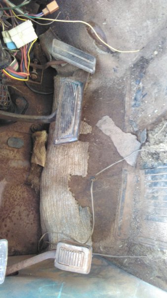

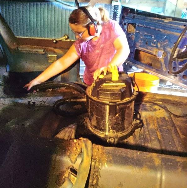

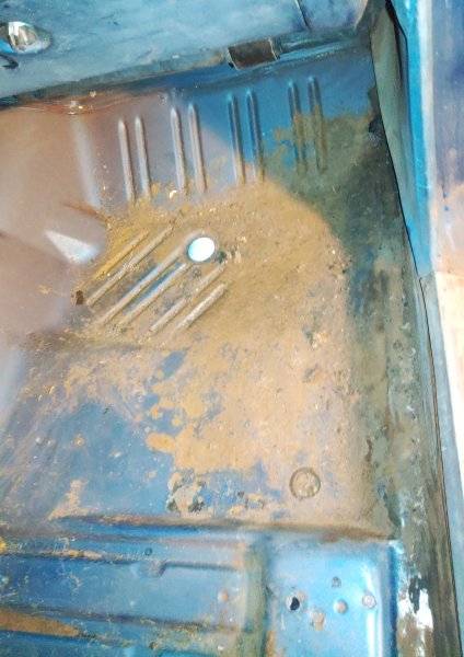

Well, the 11 year old and I tackled the floor pans today. I manned the wire brush, she the vacuum. Pans and tunnel look pretty good. One small hole in rear driver's pan, towards the top front. Odd spot. All metal around is quite solid, with factory paint on it still. I sure don't want to replace the front pans due to the toe sections, but the drivers side has a few pinholes. She was a big help. Probably be her car some day anyway, so good she has her hands on it at this stage.

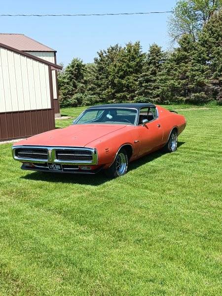

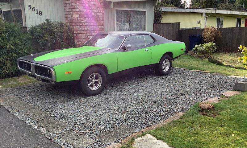

Welcome, nice project. I found this 71 and got her back on the road as a driver for now. She's been setting for 30+ years when I found her.
Nice purchase!!!! Driver's pan looks REALY good, better then most & better then my 72's was (Ziebart undercoating saved mine) up here in Philly PA area. 20151211_145957.jpg20170730_172717.jpgCheck inside c-pillar, you can't sand it well, but slop tons of converter then prime & paint, will save your paint job on outside.
Typical driver's floor!! Again, nice car!!

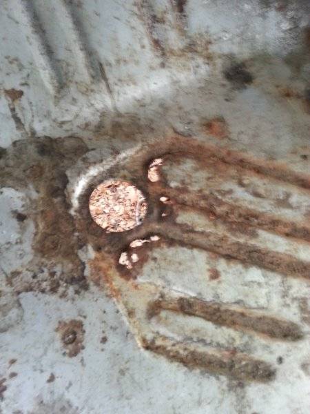

Nice looking car JDmac. The drivers area isn't terrible, but in wire wheeling it I am not hitting much metal, just rust. Worried it will be a weak area of I just do a rust encapsulation on it. The underside is great, still intact undercoating.
Yes drivers floor, replace it where needed,
Encap I was refering to was C-pillar insides, SHOULD be only surface rust, hard to get to for sanding.
Good advice. I'll take a look and see how it's looking, then will treat it for sure.
