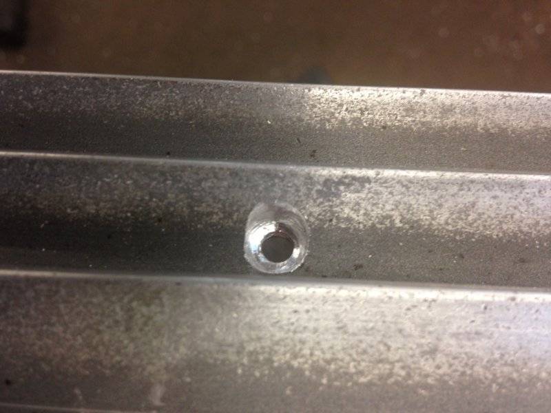

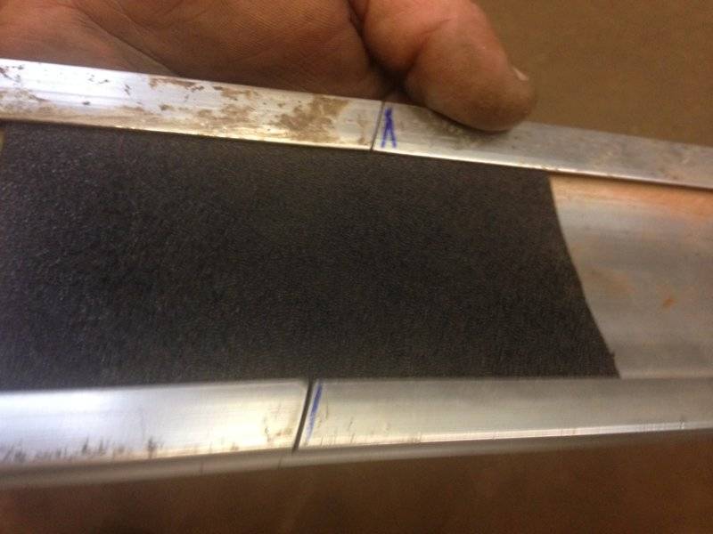

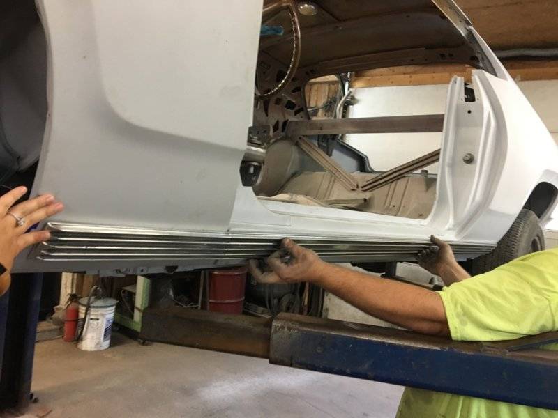

I ended up measuring and cutting each rocker molding right at the fender/rocker gap and at the same angle as the end of the rocker molding. I then took one spare molding and cut the end off each side to give me the extension pieces. I drilled and counter sunk holes the length of the molding as well. I used a piece of abs plastic that slides into each piece that will keep them lined up.
They fit very nice and the seam is almost unnoticeable. Next is polishing and some new paint on them.. I have soaked a few pieces in oven cleaner to remove the anodizing so I can polish them.. So to anyone that wants a set and can't find a set this idea does work even though I had a number of people say yea right or good luck with that idea
