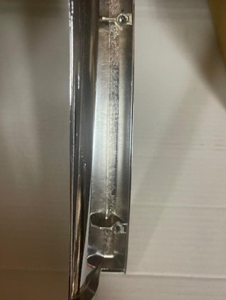

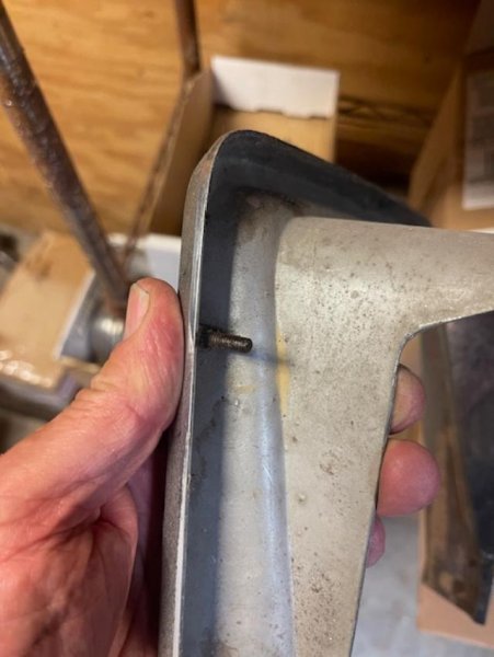

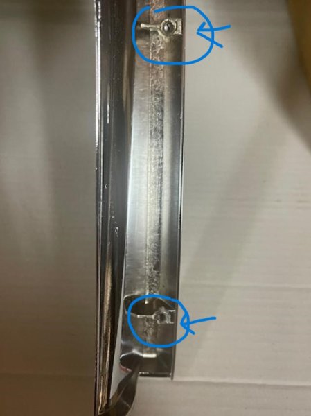

I bought a new pair of C moldings for my 67 Charger from Year One. Year One advertisement stated that they don't provide the hardware. There are machined studs that screw into the C molding and you secure with a nut. I want to know if there is a source for the 8/32" threaded post that is inserted onto the C cmolding to accept the nut.
I can screw a 8/32" machine screw into the molding( see attached photo) . I was thinking of cutting off the head and see if I can install a nut onto the threads. Or if anyone has attached with a different method, I am all ears. Thanks in advance, Dean.

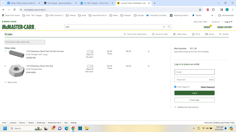

Just spoke with them and they have 5/8" long , Part# 94105A316 (Pack of 50 for $10.85) or the stainless screw is #94355A198(pack of 25) for $6.82.
So once installed into the molding, I should have 7/16" remaining on the stud to accept the nut. So I will probably go with the stainless part. I only need 6 screws so I guess I will add the rest to my collection. I'll report on how it goes. It is better than cutting and filing down the screw and fitting a nut.

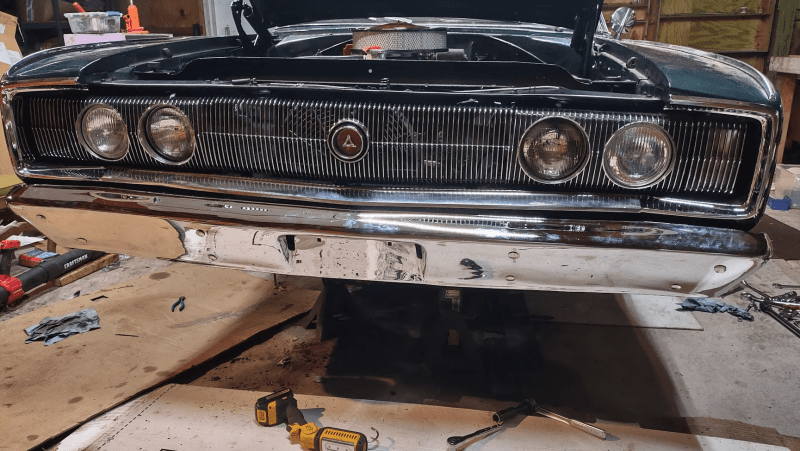

I have received the 8/32 set screws and 8/32 hex nuts in stainless and installed on C molding. See photos.
