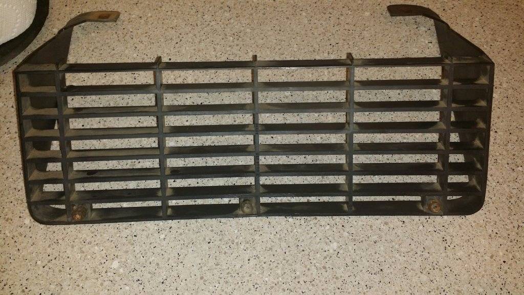

So my 71 SSP was a basket case. I have all 4 grille pieces.
ALL the nuts/bolts/screws etc... came in 1 box... unmarked.
Can someone take a picture of the bolts/screws used to mount the lower center grille piece please?
What screws into the 3 metal caps?
Thanks,
Patrick

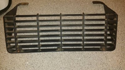

Lower center grille piece. The one in the front valance.

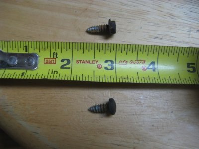

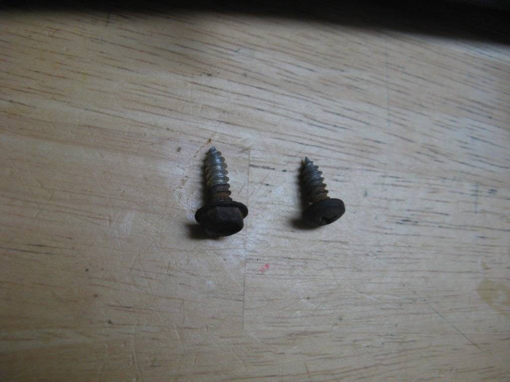

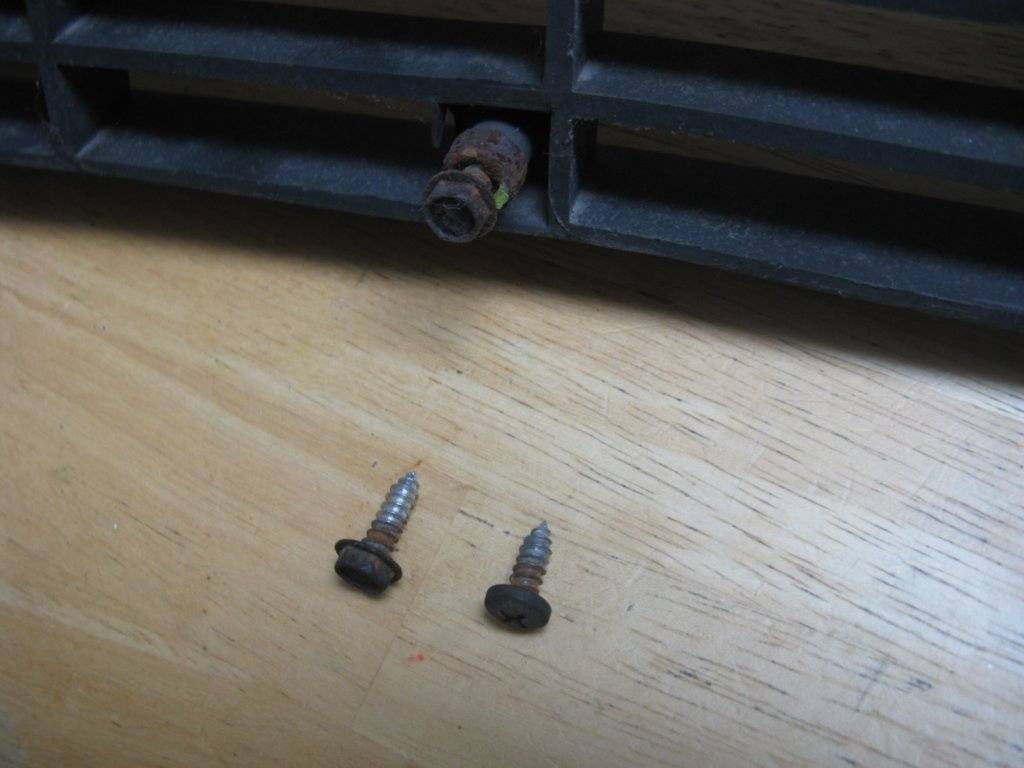

Depending on your car they could be Phillips head screws or hex head screws I have had both on 71 and 72's. Five of the same to install. Three across the bottom and two on the top. Here are some pics of both. The Phillips heads are shorter.
Thanks QuickBpBp I was able to find 5 matching hex head screws that should work.
