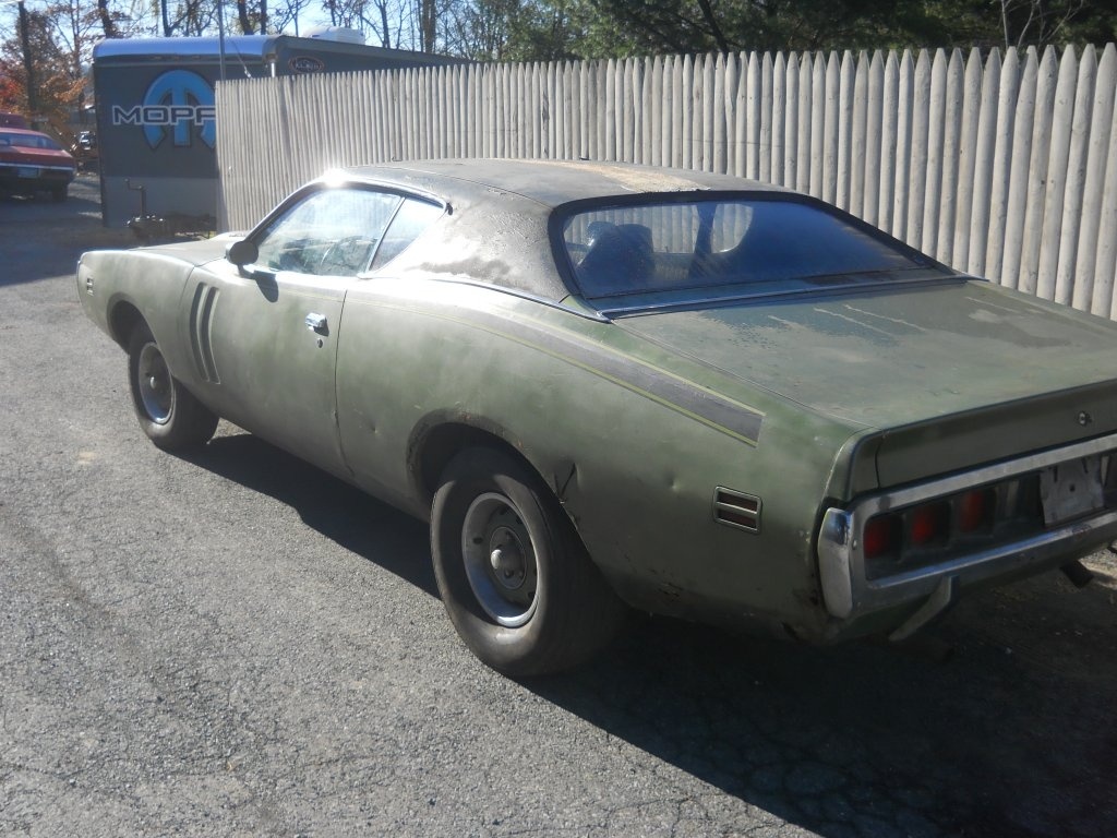

1971 R/T Barn find. Bought it to Strip???
Well B5bird is not interested at this time. Snow his way and can't make the trip. The engine and trans were removed today. Dropped it out with the K-member. The right front of the K-member was welded to the frame. The torsion bar was frooze in the cross member so the bar was cut.. I will make it a roller using the roadrunner k-member but will not fix the frame. Left side floor has amature rivit patch. If any one is interested in the body come see it and bring cash .
All the charger r/t emblems were in the glove box. The dash plaque is still in the car "Charger R/T". Bucket seats and interior except for arm rests will be in car. So what will be sold will be a rolling body with interior. rear tailights are nice, 72 grille in car is nice and has 72 right front fender with 71 marker someone installed. factory rims with 72 centers will stay on car.
Car also has a rally dash with clock so a tach can be installed. tic toc tach will come with car and extra guages. The casset with mic. and AM/FM radio can be included for extra. There are tons of parts going with car such as rad. and shroud extra rear pan for tips. Please no dreamers just come and get it out of here. Bring some cash don't waist my time. you guys know where I am at. Don't be brave and come at night. I just had to save another thief who "Duke" and "Bullit" ripped up.
It seams as soon as I post pics of it in the unfenced front yard people get brave.

sounds like its been hit on the right front , think you've found why it sat since the 80's

The frame is an easy fix. The Nut is still in the frame. It looks as if the frame spider cracked from vibration from an out of balance motor or a loose bolt. The rail is not hit or rusted at all. The k member is usable I cleaned it up and put it back in I kept the skid plate . It was dented so I cut it off and straightened it in the press glass beaded it so its a keeper. keeping the lower arms and the stabilizer. I installed the Satellite arms and drum brakes as a unit. If I don't need the spindle the discs will be with the car.
What I did notice is that the 71 arm rest are different on the under side then the 72. The 72 are made better and cannot roll up on the edges. The metal on the underside is on the top of the outside edge of the vinyl instead of under the vinyl. alot better design. They are not the original panels so I am keeping the black armrests.
I found the drivers side floor is the only patch on the floor. and the rear rails were molested for a trailer hitch as was the rear bumper drilled. Seen this before on other cars. The roof has no holes. just surface rust. It looks like Quarter skins lower and the drivers floor are and the right front frame repaired is what the body needs. I had to cut and repair these before when the nut breaks free in the frame. I am wondering if that is what happened.
