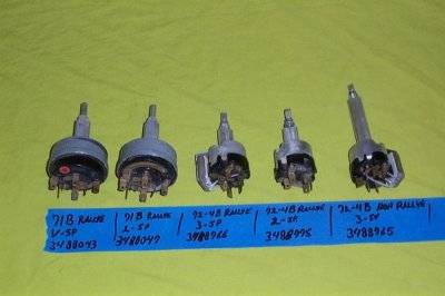

My electric washer pump stopped working, the original wiper switch still operates the wiper motor fine. Is there anyway to repair the washer function or do I need to find another switch which I fear is a '71 only part? Does anyone know the correct part no. for the switch? Thanks.

Yes, 71 is one year only switch BUT you can get a 72/74 switch and change the plastic plugs to 72/74 too. Wiring is the same in all 71/74 just diff prong disposition between 71 and 72/74
For PN, here some. All Rallye cluster available, and one standard cluster
