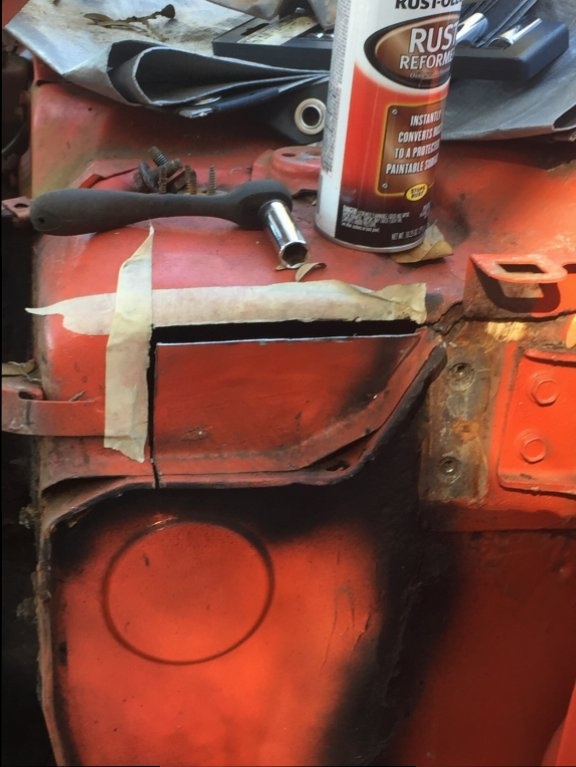

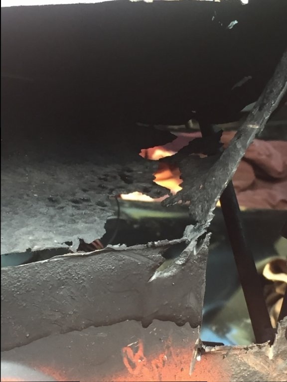

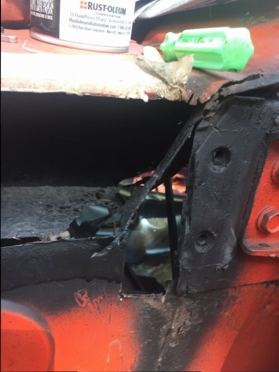

Anyone tried this without replacing entire cowl? Someone waited too long to clear the side drains and blow the hardened muck out. Putting in new floorpan and this has to be fixed first.

Yes, I hated to do it, but the only way to get to what I needed to, was to cut the top. The top part was in real good shape and I cut it with a dremel tool (real fine cut) that I welded back in when I was done.
Most of my damage was close to the driver side. I know there's several ways to go. I've been warned to stay away from Fiberglas repair. I was told after a while the Fiberglas Mat will begin to seperate. I'm thinking sheet metal bent into a U and use seam sealer to attach above what's left of the bottom of the trough? It's sad that the design has caused the end for many of these cars.
When I did mine about 5 or 6 years ago, I replaced the rotted out areas with sheet metal that I shaped and then welded to good metal. There were more areas that were rusted, but not rotted out. After I finished with the repairs, I painted that whole area with por 15. It still looks good. I don't know about attaching with seam sealer. If you're not welding it and its not a structural area, you may be able to clean (remove the rust and rustoleum) it and use a panel bond. The funny thing is, after I went through all the trouble of fabricating the metal in that area, I acquired a parts car that was in better shape than my car in that area. I don't know if they still have it, but the car scrap metal place that I took it to is across SR-60.
I second the panel bond as an alternative to welding as a ton of structural parts of cars & vans are done with panel bond from the factory these days as well as being super strong! Just make sure you have some un rotted metal to fuse with.
Thanks for input. So u think shaping a piece of metal into a U and cleaning the trough as good as I can then panel bond it to the good areas of trough right? Would u make one long piece from passenger side to driver side or just like one piece starting in the middle over to driver side?

The guy that bought my 73 Charger just cut the whole top of the cowl off in a rectangle, fixed the vent stacks, and welded it back on.
