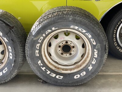

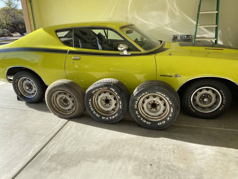

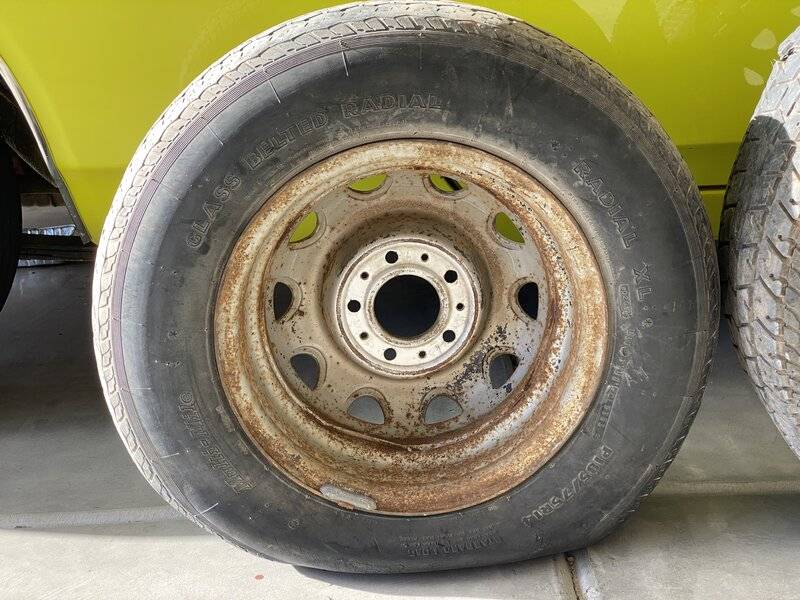

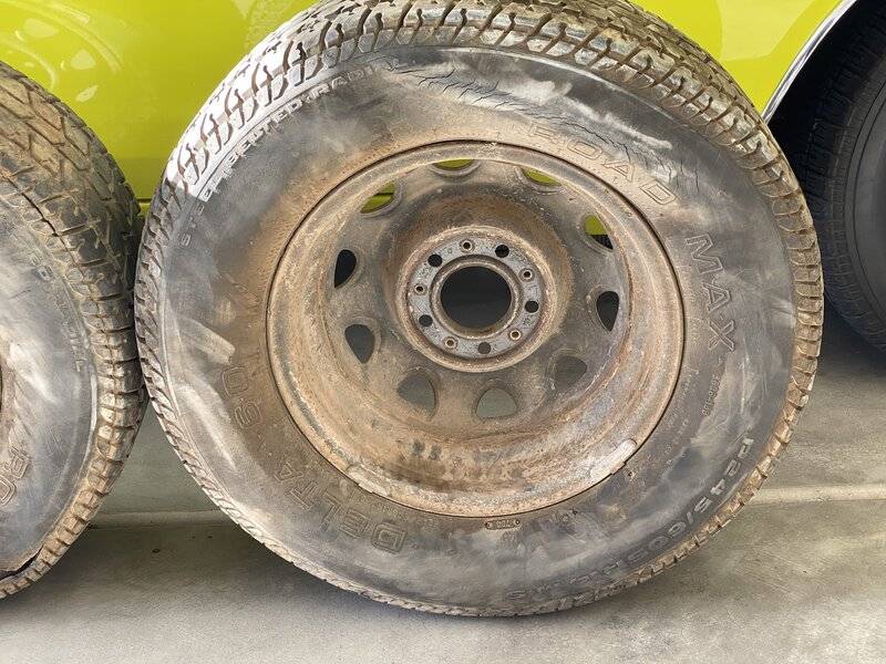

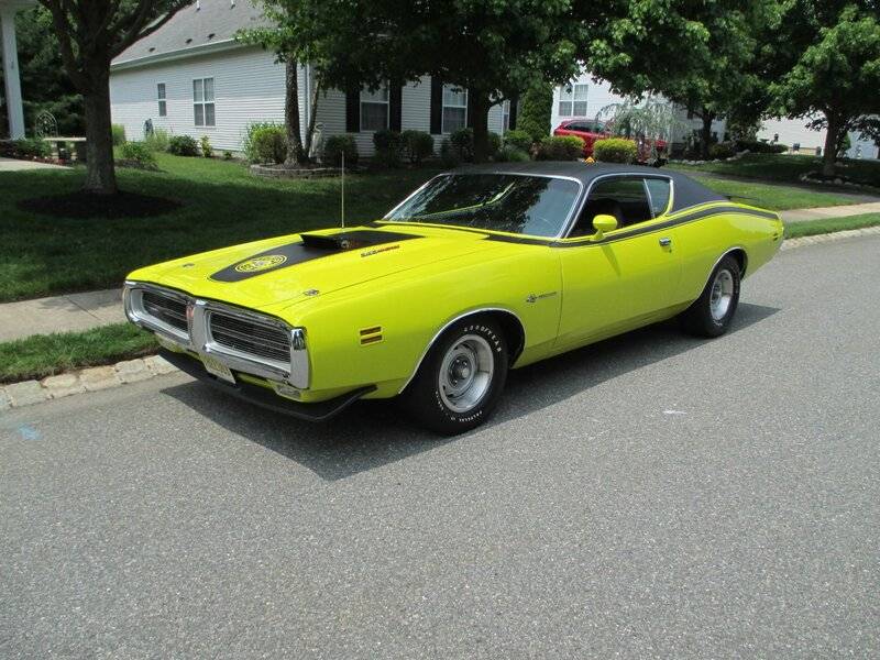

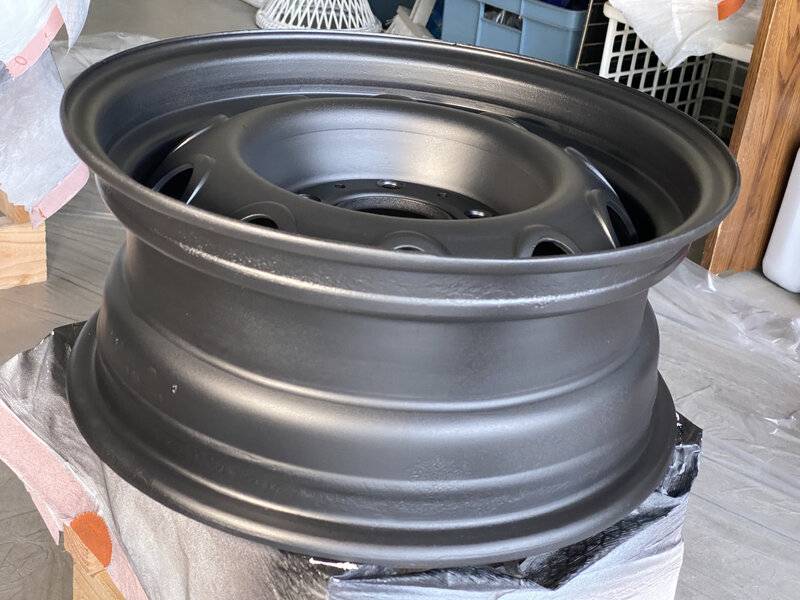

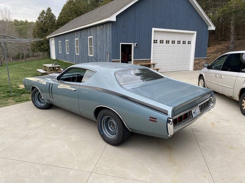

I don’t want my car sitting as high up off the ground as yours is. Currently mine is sitting about a half inch lower to the ground than stock. I am looking just to bring it up to approximately stock ride height which means running a tire that is 26.4 to 27 inches diameter. My current tires are 25.5 inches.

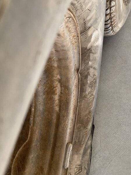

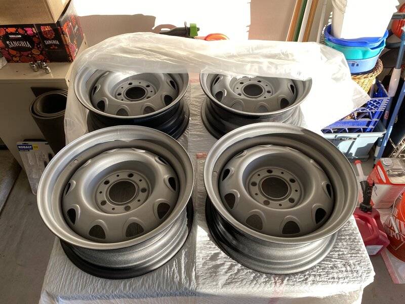

I can’t see how you could possibly be getting full lock to lock turning out of your steering box with those 15x8 wheels and 255/70 tires on the front. Your tires have to be hitting your frame rails before the steering box reaches full travel.
My current 14x6 with 245/60/14 hit the frame rails up front.

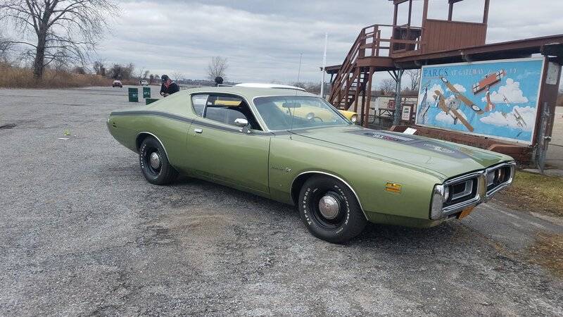

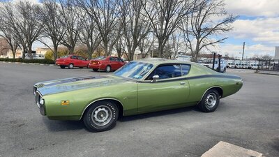

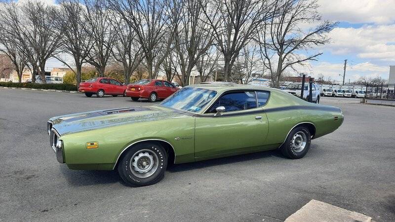

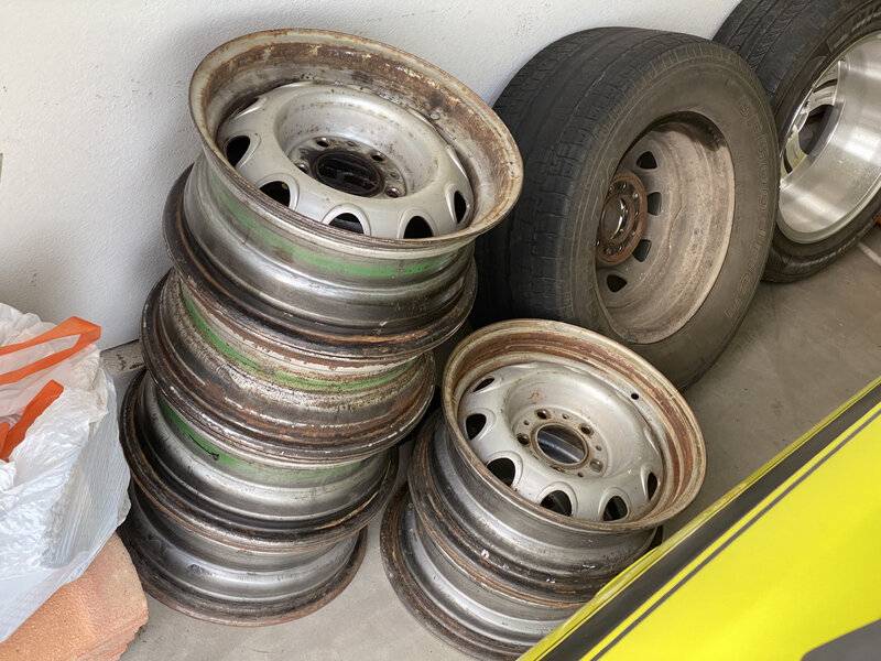

The front tires are close at full lock but not touching. That’s part of the reason for 70 series not 60 . The ride height on my cars is where I prefer it and the car’s handle and brake really good for my wife and I.
The Charger was even higher in the front with the 318 in it. Each of us has an opinion or preference on how they want their car to look and feel on the road and that’s part of the fun.
