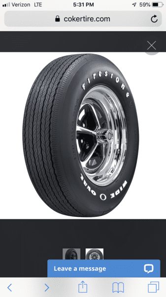

Well after learning from reading quite a number of threads on the tire subject, I have decided to pull the 1992 Goodyears off and order up these Firestone’s.
The Goodyear’s are hard as a bullit now, still have about 60% left on them (cause rocks don’t wear down much)
Coker starting making the Firestone’s in the USA a few years ago, and since I’m a hopeless RWL guy I’m ordering up today, wanna do the Frankenmuth show this year, and that’s Xway driving to get there.
Our car club friends here sure like the Coopers, but I think these will be good tires also.
We’ll see

I personally wouldn't put Firestone Sport Ovals on a 1970 Mopar. They have never been available for Mopars in 1970 and were just used by Ford&GM.

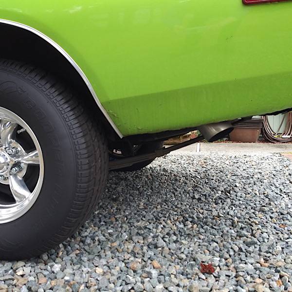

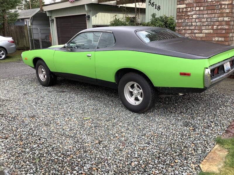

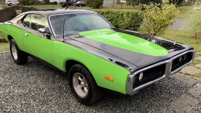

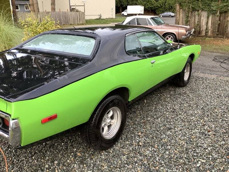

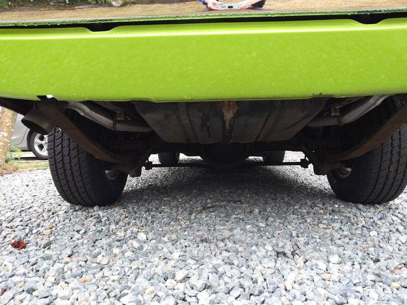

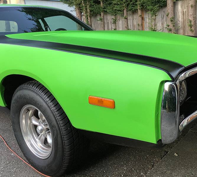

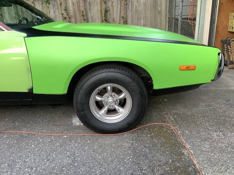

I will just put my solution to the tire dilemma here and this is just my opinion and not anything more. The 3rd gen Charger have fairly large wheel openings and I like to run the same size tires on all 4 corners for rotating and to improve handling. I prefer taller sidewalls and a good width or footprint.
My Charger runs Cooper cobras with black side out on A/R 15x8 polished aluminum wheels. Size is 255/70R/15 and the Cooper tires really feel good and especially in wet weather. They are relatively inexpensive as well.
Again this is just my opinion and that’s all. :thumbsup: :steering:

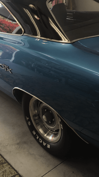

Did you order bias ply or radial Wide Ovals? And in what size for what size wheels? I bought Eagle ST for my Challenger in 1992. If Eagle ST were still available I would probably buy them for my Charger.
I was looking at the Firestone Wide Oval radials this weekend. I see Coker has a Wide Oval radial in both G70-14 and G60-15. The tread on this radial does look similar to the bias ply tread.

I don’t want my car sitting as high up off the ground as yours is. Currently mine is sitting about a half inch lower to the ground than stock. I am looking just to bring it up to approximately stock ride height which means running a tire that is 26.4 to 27 inches diameter. My current tires are 25.5 inches.
I can’t see how you could possibly be getting full lock to lock turning out of your steering box with those 15x8 wheels and 255/70 tires on the front. Your tires have to be hitting your frame rails before the steering box reaches full travel.
My current 14x6 with 245/60/14 hit the frame rails up front.

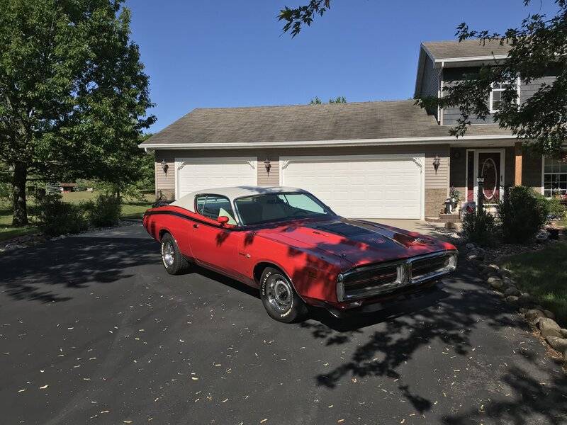

I went with the FR60-15, (car was built with 14's). These are a little shorter & narrower than the Eagle ST's, but getting a 1/2 inch lower is good for me, I have liked a lot of tires discussed on this thread but am always wanting period stuff for this car when I cant get NOS/OEM. Most of my enjoyment is the history of these cars and the era, and for those who know me, they know I enjoy the searching/finding/buying/keeping this car as close to the build sheet as possible. hell, I still cant bring myself to update the front drum brakes to disc's.
