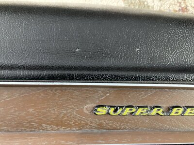

1971 Superbee Dash Emblem
Impossible to find
This picture is not mine , but a lot of my yellow has faded away
So I say , why not repaint - Don’t even have to remove the dash piece
Well , if it was that easy correct
Anyone done it ?
First off , the color - Y 3 Citron Yella maybe ?
That would bee key , correct color
Then a paint brush I would assume leave streaks and lines
How about a small detail sponge brush ? Like Testors sells
Anyways looking for ideas or suggestions - Thanx Scott
Not my picture , just reference
My 2-cents? Take the dash piece out and paint it by hand. Try some Testors mold del paint or a closer color match if you can find it. Take your time
Thinking this direction with sponge brush
Testors Paint Pen might bee another option - But again the correct color would bee impossible
Unless a Mopar paint company put into a pen or chip bottle for touch up paint
Testors® Micro Sponges - 10 Pack
I believe those are "pad printed".
I've not tried it, but the general idea is to have a flat, semi-absorbent pad soaked with paint, and basically gently "roll" either the part from one end of the pad to the other, or the pad onto the part.
Thanx
That definitely makes sense , as far as how smooth and fine it looks
More research on that
Thanx again
