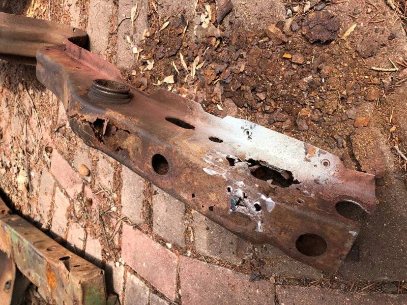

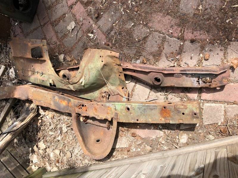

So awhile ago I posted a question asking how much it would cost to have some frame repair done. After hearing the responses I was left with the option of either abandoning this car or tackling it myself due to the cost. I had taken a welding class years ago but that's it. So I bought a welder, spot weld cutter and found the replacement parts online and jumped in the deep end of the pool. I used all goodmark replacement parts and found them to be very good! They are all high quality and matched up perfectly.

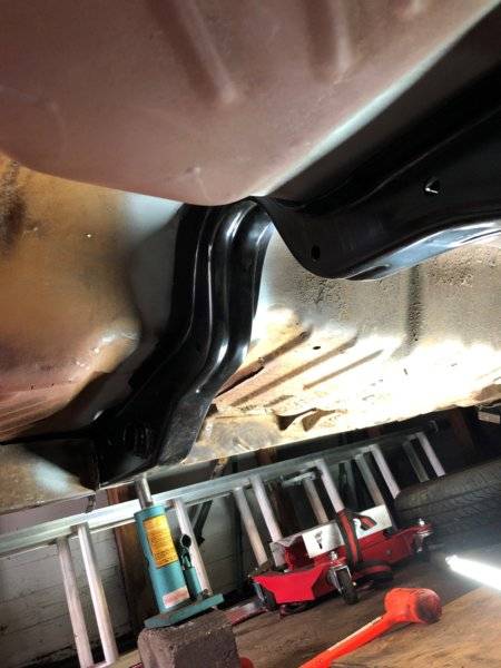

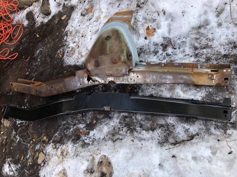

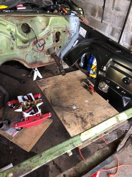

I didn't have any trouble using the Blair spot weld cutter to remove the spot welds. I removed the inner fenders and welded in the new ones (body and radiator support sides only) to kinda hold things in place and replaced the drivers side frame rail first. (the passenger rail was fine and didn't need replacing) I read on here that you can just bolt the new rail up to the K member and then its pretty much in the right location, so that's what I did. I had to measure and was having doubts about the shock tower placement, since it comes separately from the frame rail but I think I got it in the right place.

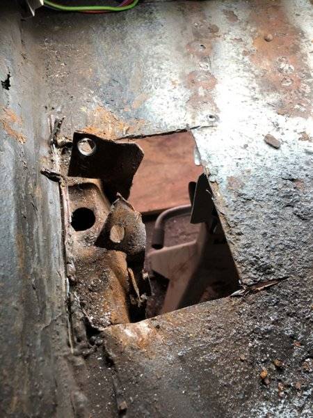

When it came to the torsion crossmember I decided to just cut out a small section of the floor so I could access the welds sandwiched between the floor and body and then cut through the floor for the rest. That worked great! I soon realized that you cannot weld sheet metal with flux core welding wire, so I am gonna have to buy gas to mig with for the sheet metal floor repair.

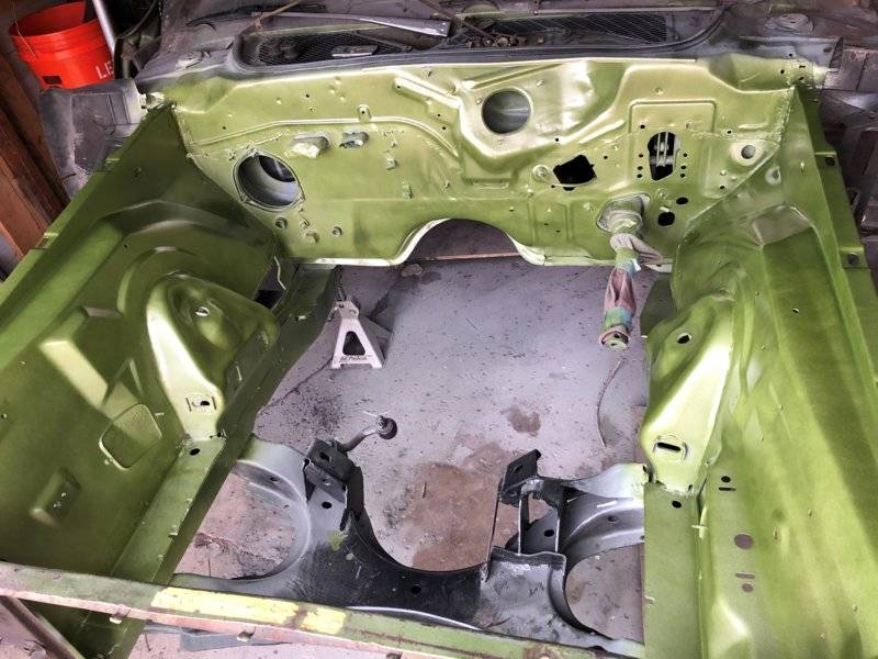

Anyway I was able to do all this by myself and I'm a novice for sure. In total I replaced the drivers frame rail, drivers shock tower, torsion bar crossmember, and both inner fenders for about $1000 in parts. I'm not saying it was easy by any means but it wasn't as hard as I thought it would be.

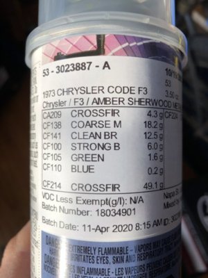

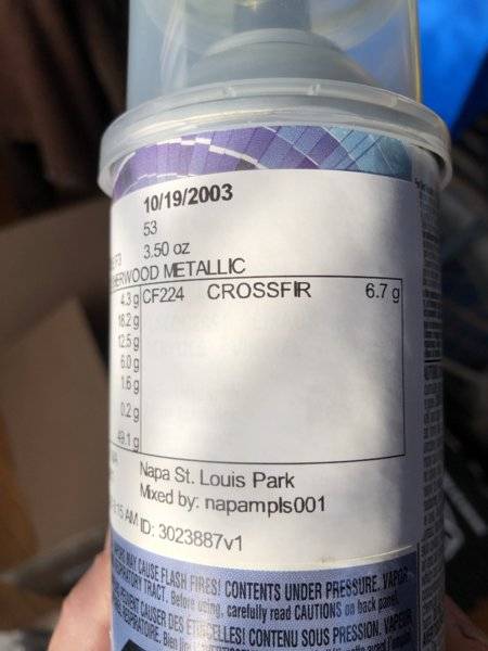

Oh and I was able to source the Mopar F3 green paint at Napa, they still had the recipe in their system and mixed it up in a few spray cans. I put down epoxy 2K primer then paint then 2K clear in the engine bay.
Maybe this will help someone else and encourage somebody to take on their own project. Feel free to ask any questions and I'll answer them if I'm able.
Feel free also to refrain from bashing my job in my single car garage on an uneven floor without a jig.

congrats....... the sheet metal only fits one way and dictates everything..... no jig required......people who have never done it love to over think it........ the cat's out of the bag.......... right @Kern Dog ?
Looks great! Did a similar job on my 71. Except I left the towers & aprons all attached untill after the replacement rail was in. I bolted mine to the bare K & slid it in bolting it to the passenger side as well. I measured a ton but it was pretty straight forward. I did add a 1-2" stitch of weld every 6 inches around the perimeter of everything that was replaced(where there was a flange or overlap). Its a lot of work, I know it makes you proud to look at it now.
No bashing from my end. Excellent work!
Mine was more extensive after the rail. Replaced aprons, front pan, firewall, & upper cowl.
Nice work it looks great. Can you share with me the code for the F3 paint? I was looking for some for my project.

Thank you so much. I had ordered some a while back and the color was way off. Keep up the good work on the 72. What is the interior color?
