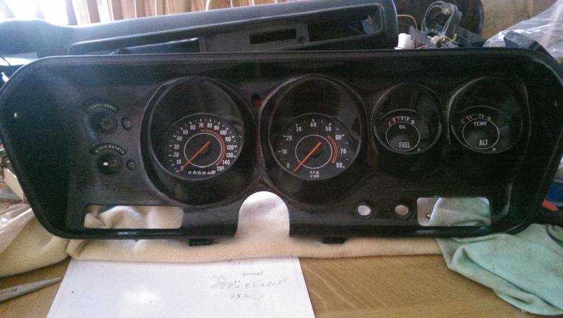

This particular one has a 150 Speedo with the clock (no tach)

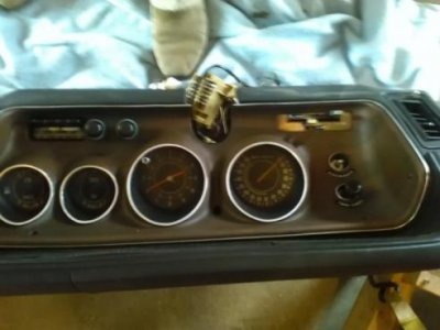

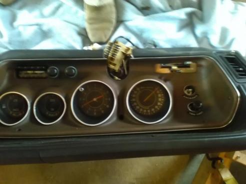

This one has the 150 Speedo and I added a tach to it .
if yours has a clock s tach can be switched in ,in replacement of the clock.
