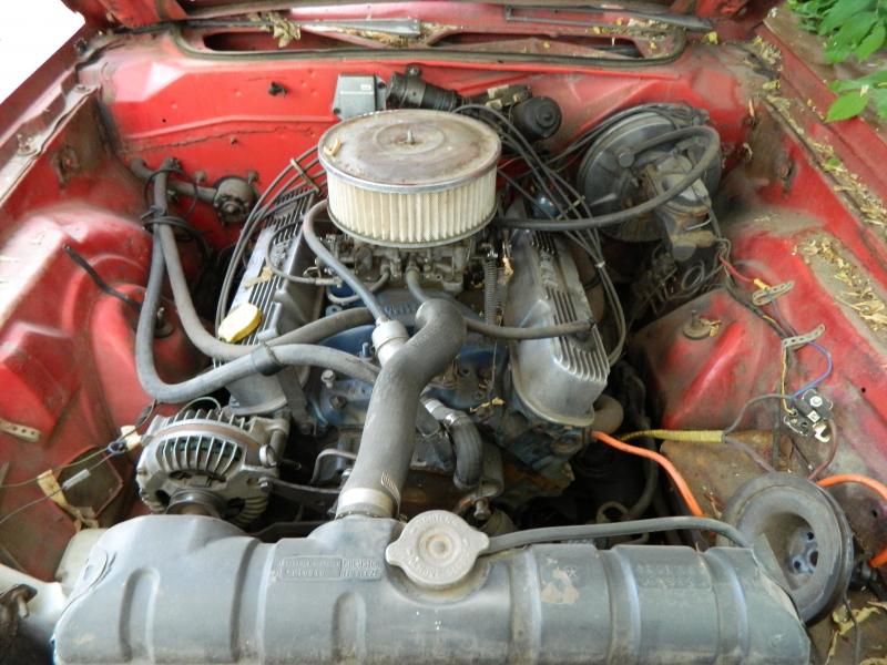

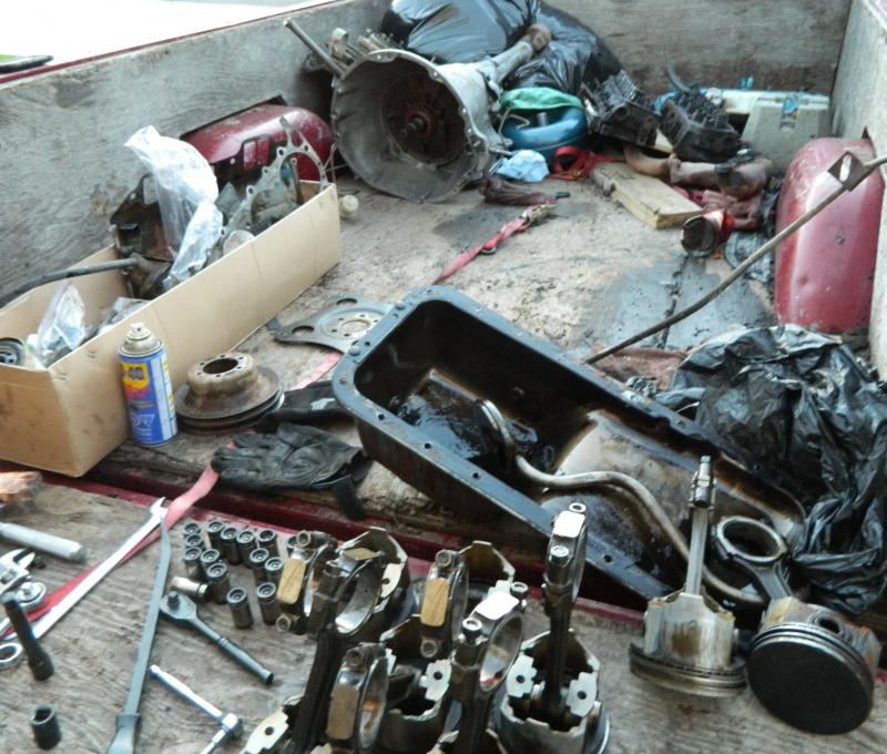

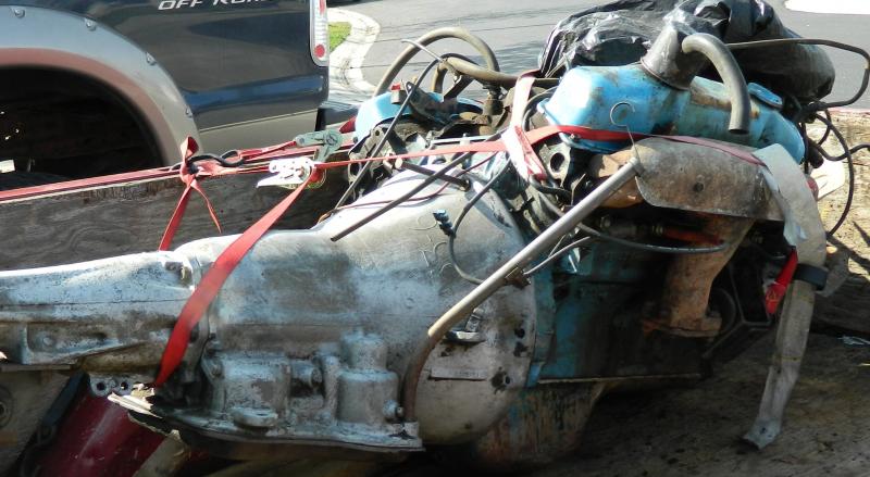

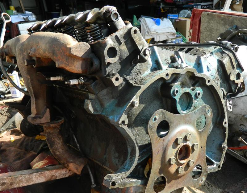

Well guys/gals I have a 1972 charger with a stock 318 with a auto trans and will be building a stroker from a 400 block, with a 727 trans hoping to get over 500hp to 600hp. I just bought a 400 with A727 B with 52,000km for 200 bucks and was running, I started to strip down the 400 and seperated tranny and block today, in such a rush that I still have not taken out of truck yet, lol I hope to pick up a engine stand tomorrow so I can start draining the engine, If there is anybody that knows for stuff to NOT do while taking it apart chime in. It was out of a 74 charger SE and seems to be a good block as it has the extra webing on the sides, I will post post pics as I go and thanks in advance for any advise.

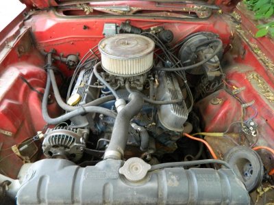

Here are a few more old 318 and stroker one day 400
new to be 400 stroker just starting to tear down. Hope to get engine stand tomorrow.
...and for those that question the fit, those are 75-77 front seats.
Really, well that god I'm not have all original charger, I should show more pics and see what other info I will get about the car I bought. Thanks

These are my break down to get ready for the stroker. You like the work bench, lol
