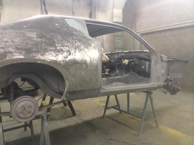

Sandblasted

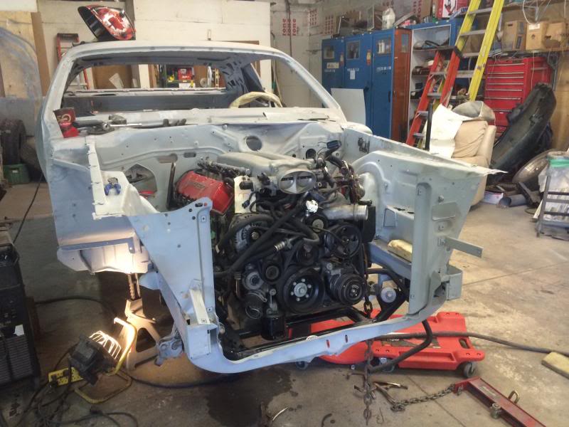

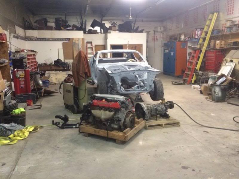

In under it's own weight (This took a while, lots of headaches)

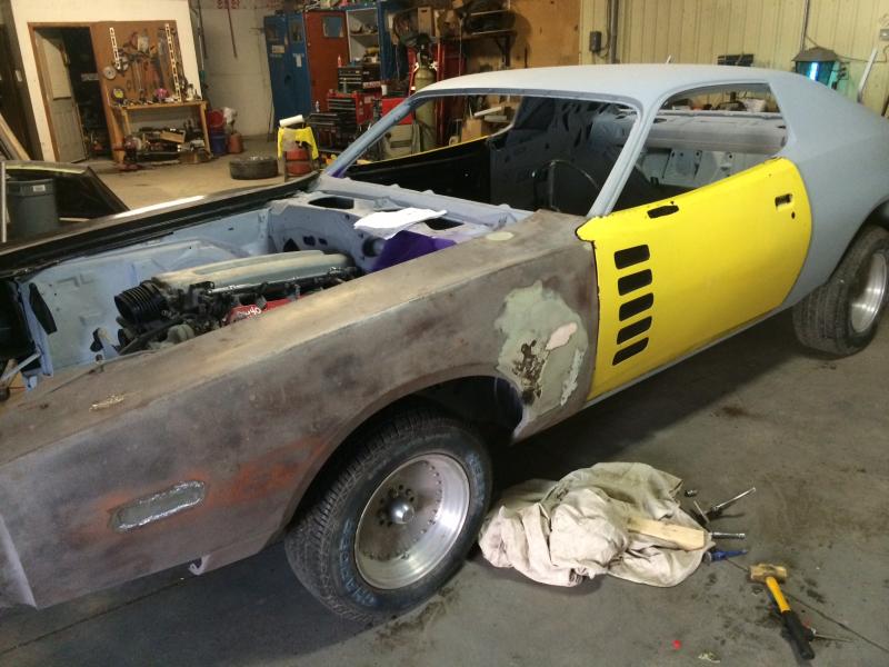

Suspension mocked up, had to modify the factory Viper oil pan, it's not symmetrical, and the Pass. tie rod was making contact

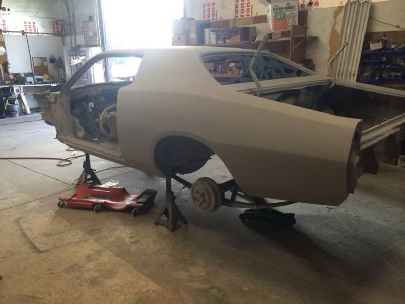

Test fitting panels.. The doors were rust free.. And $650 for the set...

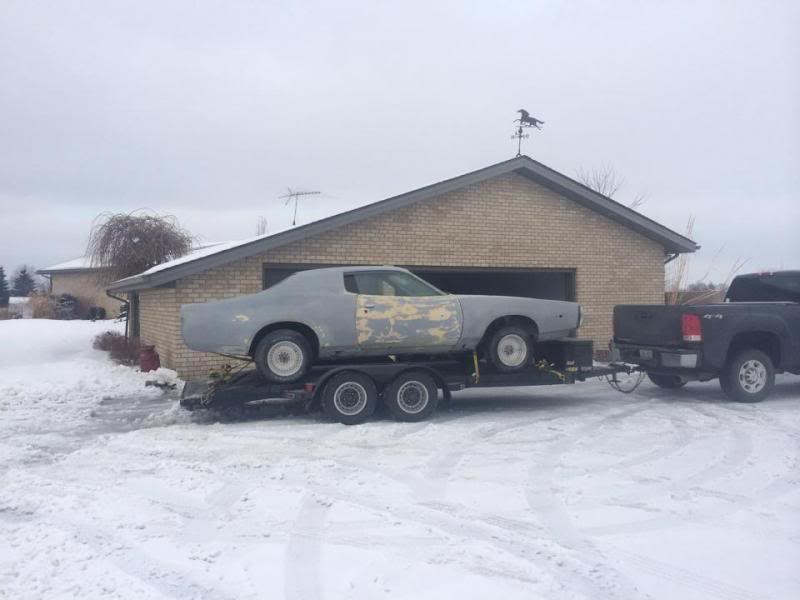

Found this in Chicago, After the hotel, beers, and keeping my at the time lady friend entertained.. This costed me around $2800..

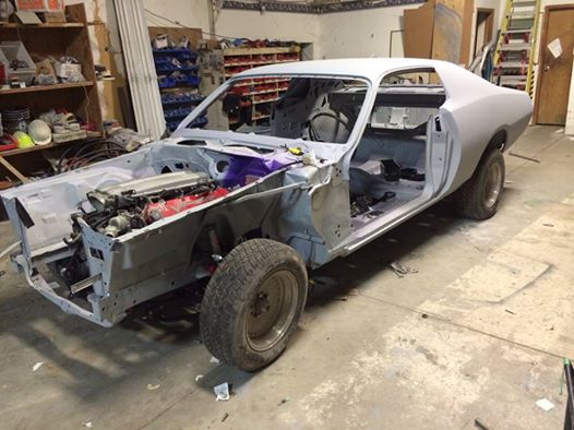

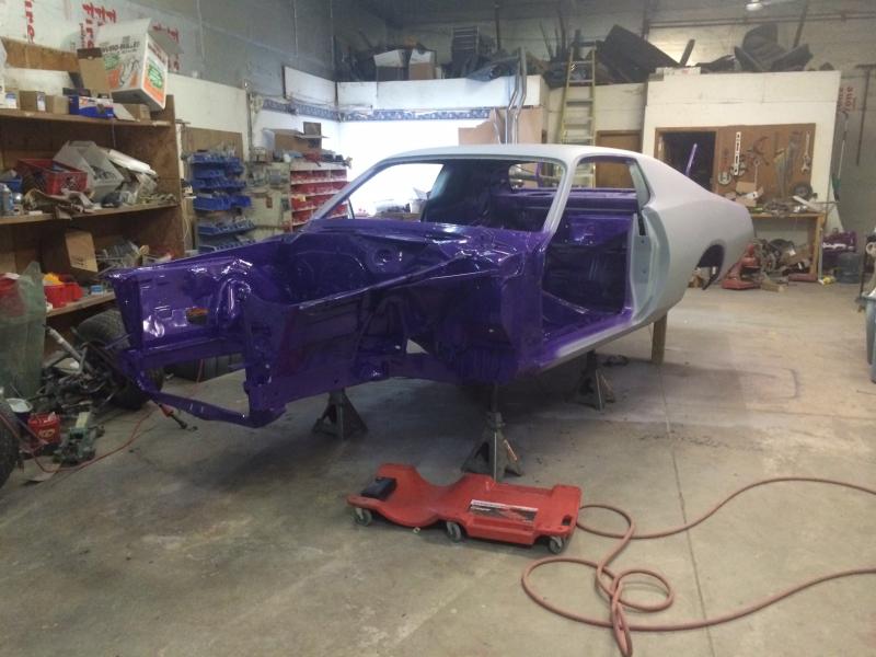

This is as of last weekend, underside painted, inside, trunk, firewall, and wheelwells done in single stage urethane 2014 Plum Crazy Pearl,

Looks great!!! cant wait to see the finished car... The fenders are not easy or cheep...I had a lady come with in inches of my driver side...she couldn't understand my blood pressure.

Yeah, 98% of people have no idea how hard parts are to come by, I had my sheet metal guy rebuild the mounting points, and the inside of the fenders, he couldn't understand why.. Until I mentioned that I had to drive four hours to get it.. And it cost me over $400 for just the passenger fender...
I also filled in all of the markers, antennae, and turn signal post holes on the car, should be pretty slick when she gets done. I'm in the home stretch now, as all of the body work is done, and I'm assembling the mechanical portions of the car..

There's a ton of room, I have to put the rad infront of the rad cradle, but aside from that, I can stick my fist sideways between the header, and the shock tower and not touch anything, huge improvement over my last few projects..

And on the paint prep quote, haha, I'm a little worried about cracking when I did the body work connecting the quarter panel, to the roof, I have about 50 hours of work invested in shaping that round section, as I stripped the car to bare steel.. If that splits, I might fall into a deep depression. (It's long strand kitty hair fiberglass to start, so it more than likely won't)

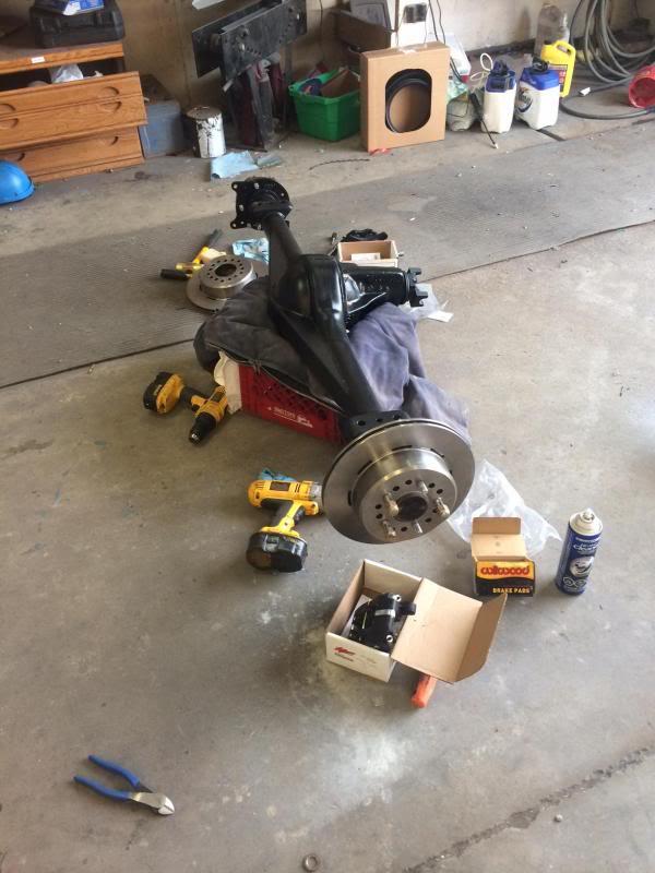

Yes, I'm going with an 8.75" rear end for now, it's been back braced, but still won't be tough enough. I have to upgrade in the future.

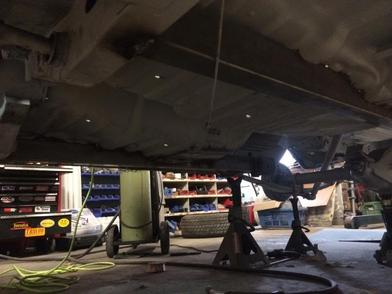

And I've installed the frame connectors, I used the Competition engineering ones, incase I decide to move the leaf springs in for larger tires in the future.

I have a few more pics, these are the most interesting of the bunch.

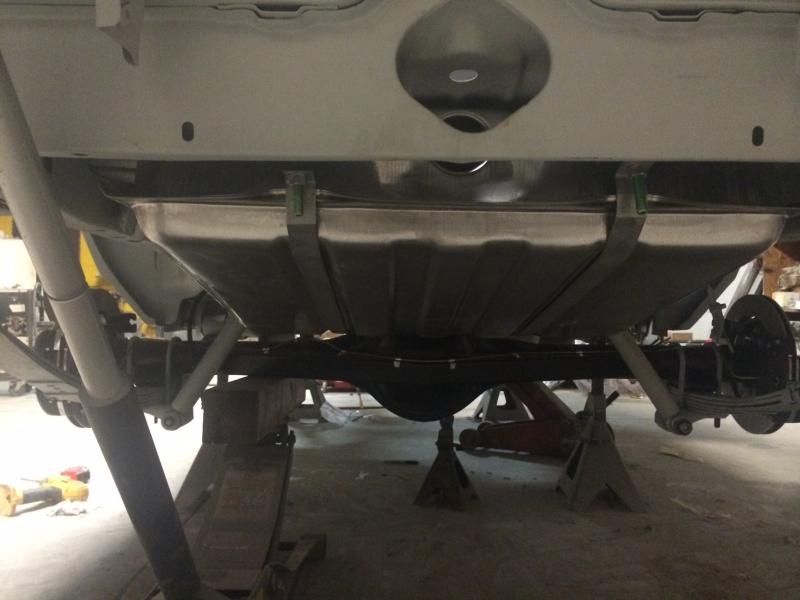

Here are the SFC's installed.
