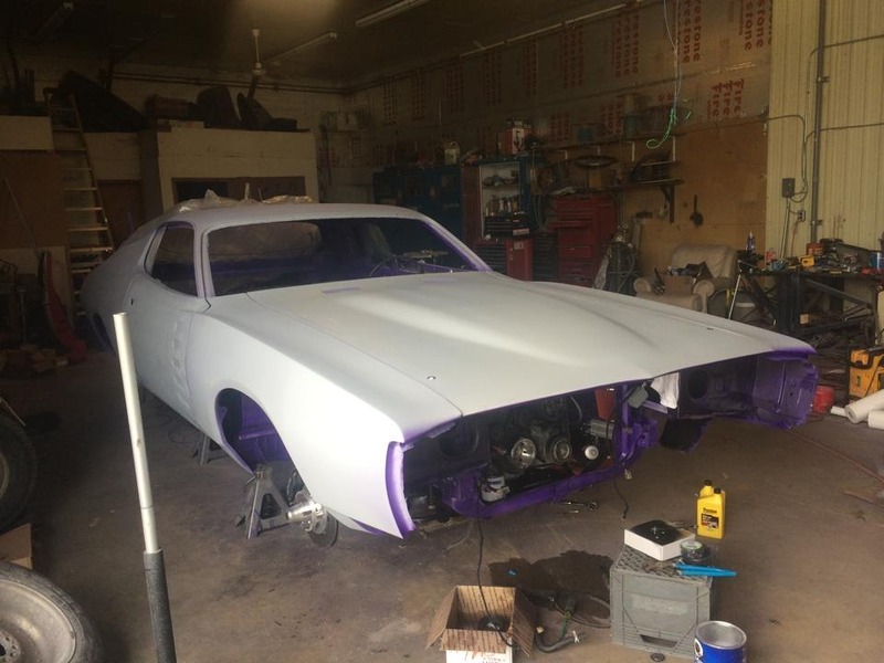

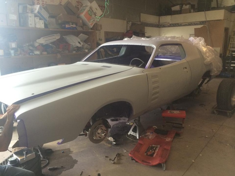

Had an appraiser come by so I can get storage insurance, so I threw the body panels on, and adjusted them.. Not too bad..

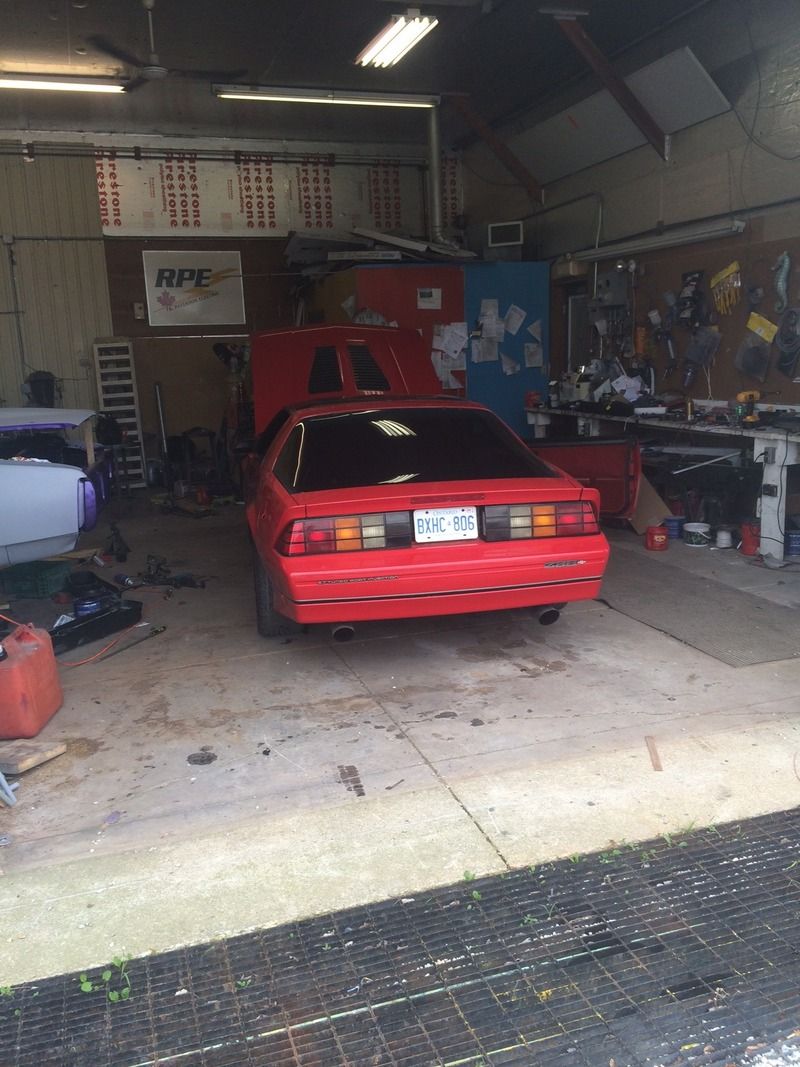

and a recent purchase has been stealing some of my time.. It spends more time like this than driving.. Damn Chevy's.. 116k KM's, 5.7 with T-tops, and red leather..
