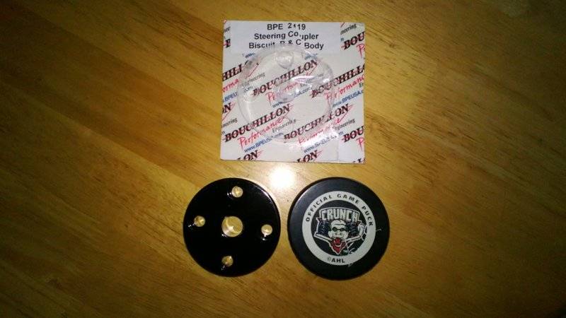

From our friends at C-bodiesonly.com...
I talked to Randy at Bouchillon this morning and he confirmed that the newest rendition is in fact solid powdercoated aluminum. He says the original ones he made were rubber but did not hold up to the heat well, then he tried polyurethane which he says smelled like crap when it got hot, so then he switched to solid over a year ago.

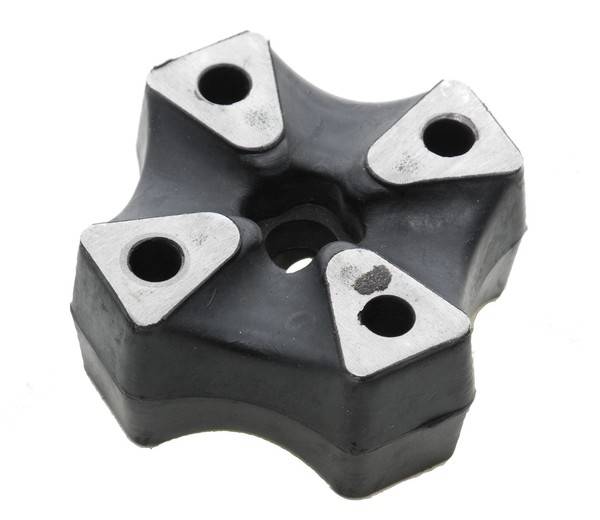

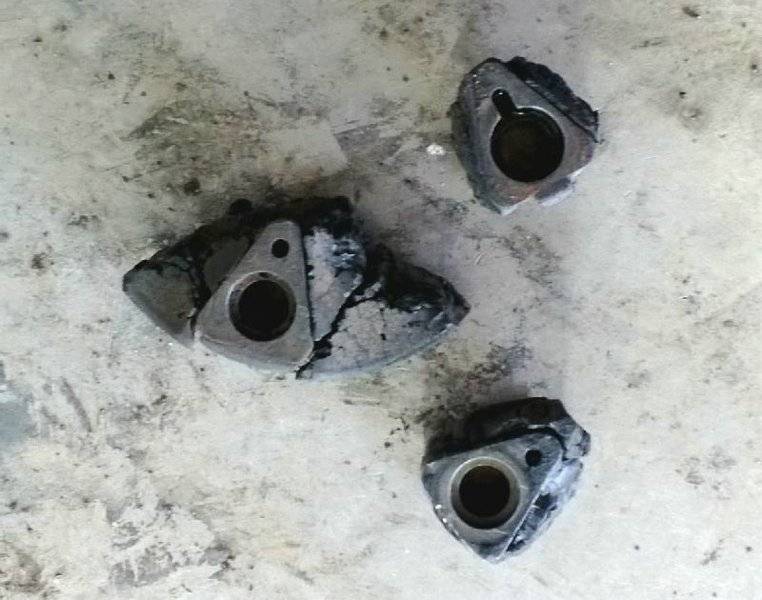

Anything but a solid one with out metal to support the bolts will wear out eventually. The original had metal supports.
The reason they were made of rubber was to absorb the bumps.

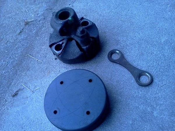

The second pic shows the supports and what was left of the rag joint.

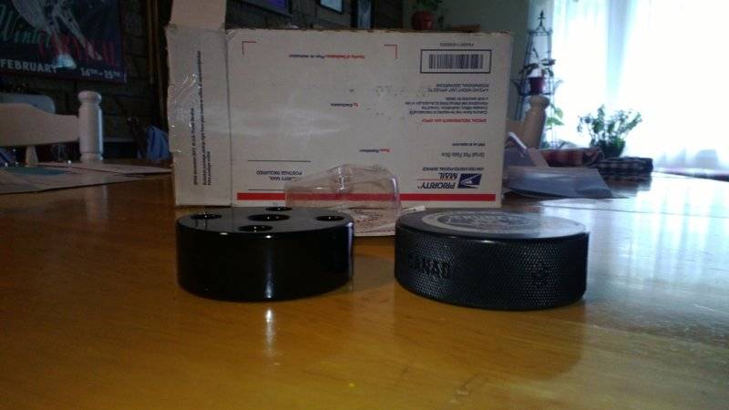

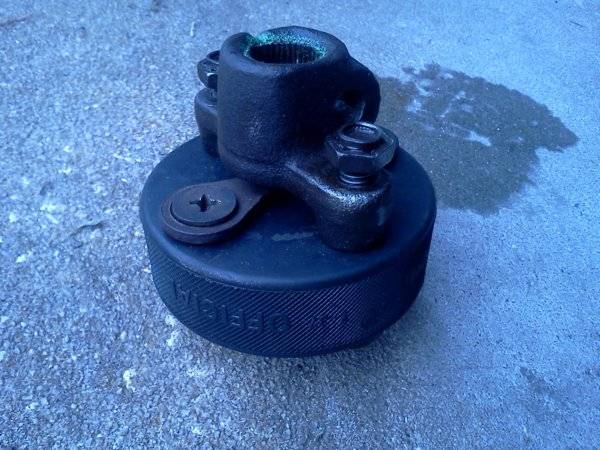

What I'd like to do is find a cheaper solid alternative. $120 for an aluminum hockey puck is a little high for me. What about a material like phenolic resin?
Note the bolt holes are different sizes.
They are recessed for an allen head. I am seeing these for as low as $15, my fingers are crossed that they will measure up. Dibs on submitting an article to Mopar Action if this works out. haha

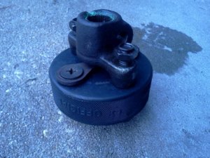

Mine was as bad as the pic posted earlier.
It's just been carefully placed back together for the pic.

Here are the pictures. I never tried it, I am not sure if the puck would withstand the heat being next to the exhaust manifold.
Here is what mine looked like!!!!

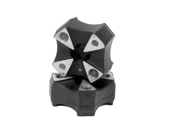

Just an update - both Prothane and Enegery Suspension list a poly coupler biscuit for a 70s/80s Datsun Z. Neither list bolt spacing that I can tell, and neither could give me an answer after contacting them (nice, right?).
I was able to get an answer from an ebay vendor who told me his original part measured 1 13/16 center to center. Assuming this is correct, the coupler is not far off, but still is not going to fit.
One or both of the poly units has two sets of steel inserts - I don't know if this will allow a larger bolt spacing or not. Anyone want to spend the $15 to find out? The height is the same or nearly the same as the 73 unit.

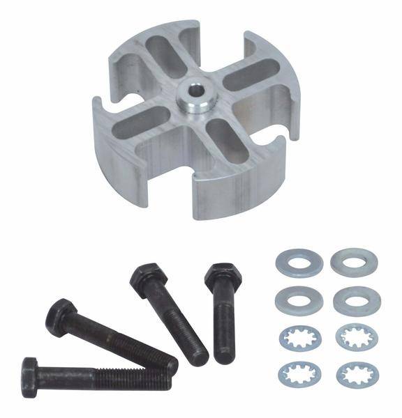

Someone mentioned (here or elsewhere) that they used a 1" fan spacer but they didn't provide any other details. The issue with the fan spacers is that almost all of them have a "nub" to locate the fan - this may or may not cause interference. Some are also open ended as opposed to closed. I suppose if you could find a closed end one that fit, you could insert a sleeves for the bolts and fill the void with a high temp liquid gasket.
