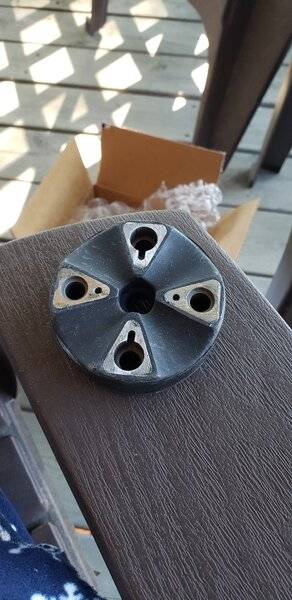

I used a cab mount for a freightliner. Cut it down a bit cause it was too big around. Drilled 4 holes in it. Pressed in some cut to right length 1/2 inch tubing in the holes. Bolted it in with the straps from the old one. Works great.
Well into year 4 with the drilled puck.
I'm claiming 100% success.
I am having my steering box rebuilt. While it is out of the car I checked my rag joint and no surprise it is pretty rough. The other coupler (highlighted in attached) just up from the rag joint is also in disrepair.Rock auto has them Lares 220
Any suggestions on whether to try and replace the rubber in the rag joint (only able to find a Dorman Help replacement part number 31002) and rebuild the coupler or go to some other design? I have heard of U joint style replacements or even something about going to a 1974 style which I have no idea what that looks like.

if It was my case, pretty sure would try the Land Rover piece before the original piece due the prices of the original one. And my next bid would be the hockey puck. IMHO Anything over $40-60 for a rubber piece with metalic inserts like that is outrageous.

The Land Rover biscuit is made the same as the factory piece, the only difference is the shape of the rubber and a small difference in thickness (which is not an issue given the ample travel of the factory plunge coupler). I think I paid around $20 for mine, and for a piece that is shrouded in a steel shield, I wouldn't be worried about the difference in the shape of the rubber segment.
