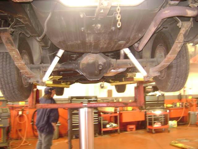

You might get lucky and still have the differential tag. Mine was still bolted on the diff and it shows the ratio.
Ma mopar is known to do odd things and change them up.
Mid year 1973 all B body wagons got the 9-1/4 rear as the 8-3/4 was slowly being phased out.
My wagon has the 9-1/4 rear behind the 318/3 speed manual trans.
