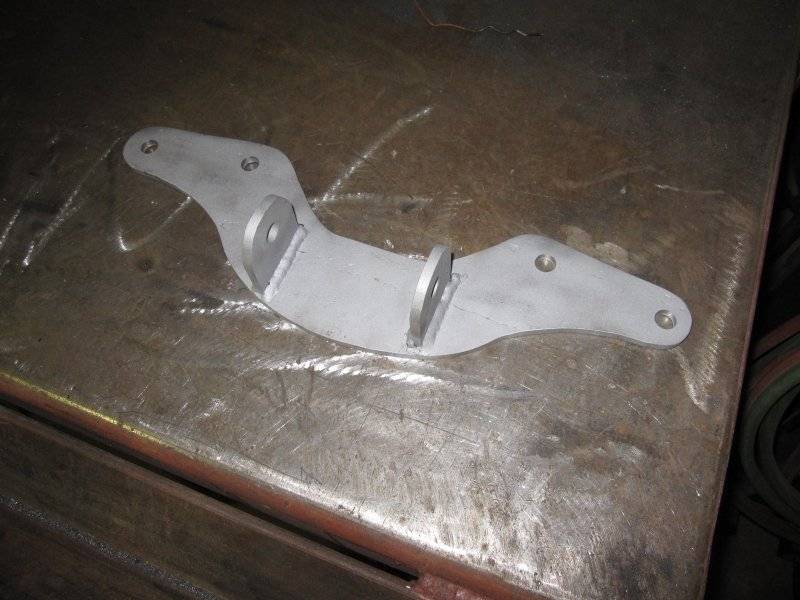

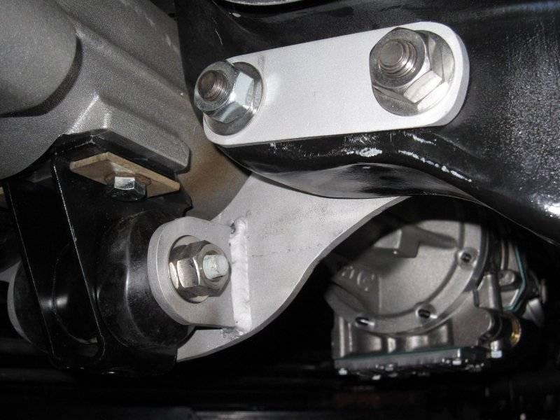

Save your auto crossmember, fabricate a new crossmember. My home made crossmember:
1/4" steel plate (or aluminum) with a spool type mount.
Mike
