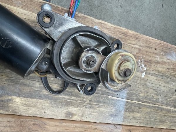

I should also mention the links to the Charger forum that the picture links are not found so I can't see how he assembled it back together.
Yes is true. After the Charger board software upgrade lot of attachments are for now temporally missed. And I don’t think have all the attachments posted there on my actual Laptop to reload them.
I think however I still should have the pics of the correct assembly for the 2 speeds setup
Note: the spring legs fit both on same side of the outer cam piece, not with the cam “protusion” in between the spring legs.
