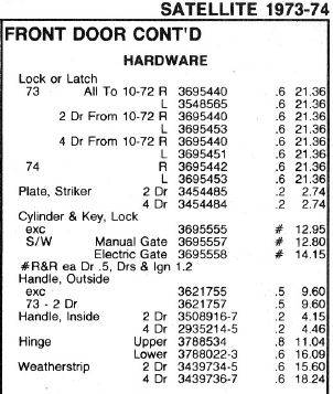

Anyway, go to my site and download the Collision manual. But here is the snip.
http://www.retrorarities.com/1973-74SatelliteCollision.pdf

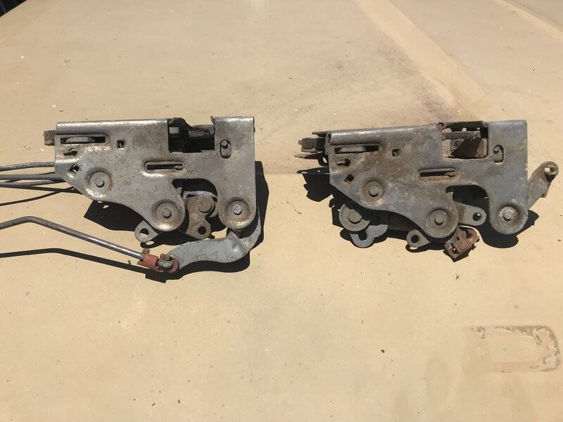

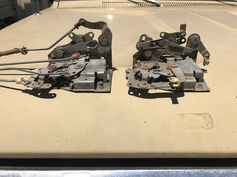

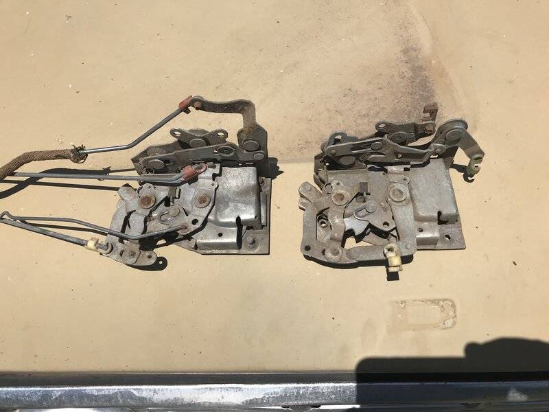

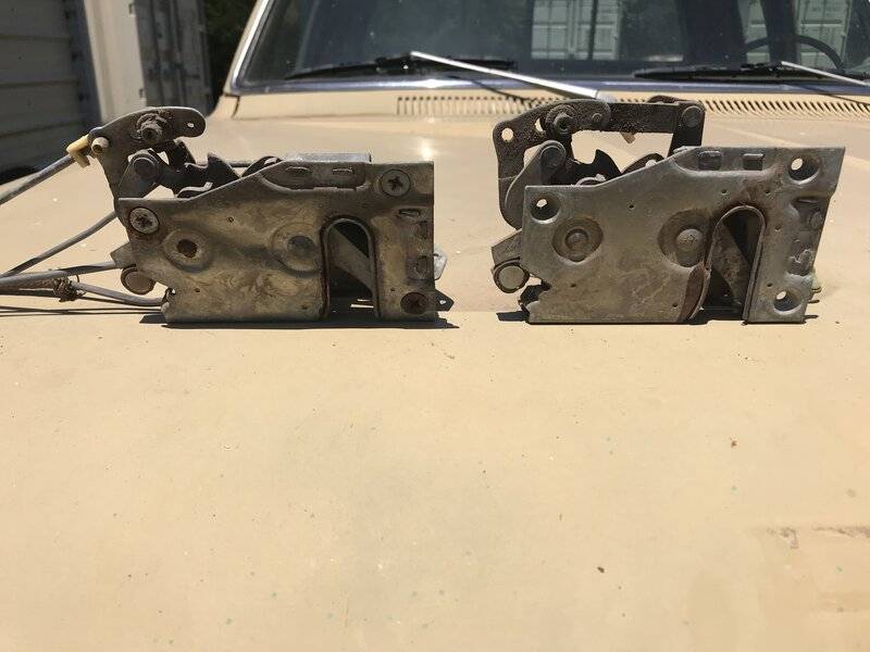

I've felt the only differences between latches within a latch family were with the release levers, that I believe could be easily swapped with a little work and a welder.
1972 Satellite 4Dr latches, both passenger side. Front door latch on the left with remote rods, rear door latch on the right.
Thanks everyone!! Looks like I need part number 3695453. I have a used one. I was just wondering if part number 3695451 would work because I can get a brand new one
