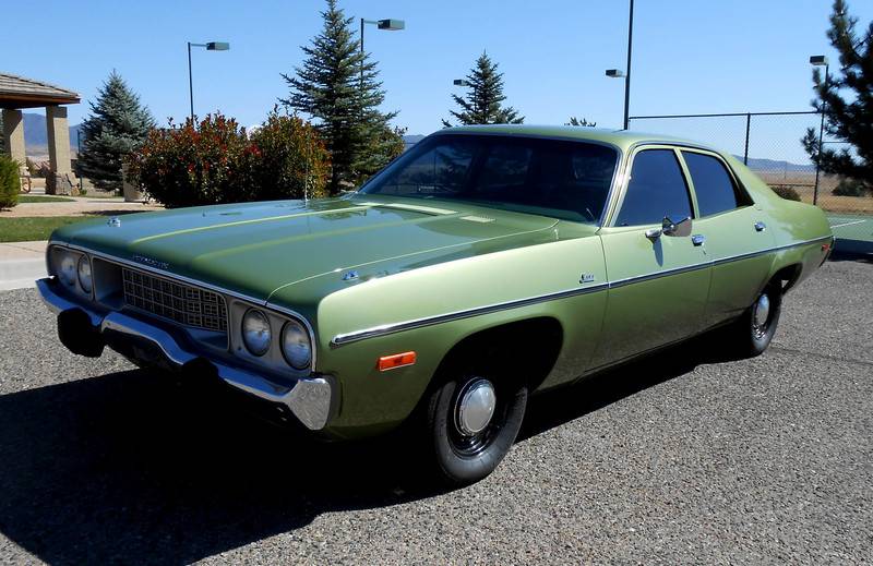

1973 Satellite sedan/wagon fenders interchange with 74?
Montclaire
3:09 PM
Nov 15, 2011
1,559
434
Scranton, PA
I'm hearing the part numbers are different but will 73/74 satellite wagon/sedan fenders interchange? I know the bumper filler changed but from what I can see online the fender itself isn't different. Hard to see below that monster 74 front bumper though. Thanks

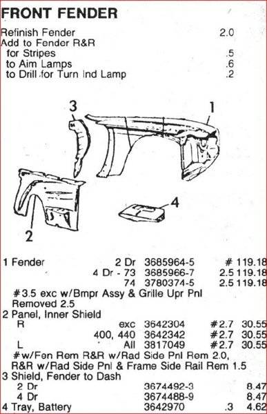

About the OP... will check later on my 74 collision parts manual if they specify just 74 or both.
Ok, the catalog says diff PNs for both years... now where is or what's exactly the diff? Can't tell
Just about to post, part numbers are very different. Doesn't mean they won't work with a tweak, but they show different #s.
