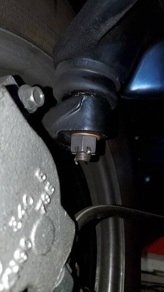

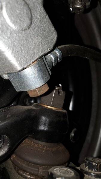

Here ya go, there should be a brass or copper (cant remember) washer with the ball joints, see these on my 73 both upper and lower have them.
Thanks for the photos. The washer that came with the MOOG K719 threaded lower ball joint was just plain steel. The Chrysler manual does not show a washer, just the nut, and the installation instructions says to leave it out if it didn't have one... Hmm... Not sure why a washer is so important, depending on application... I would think to always use one to spread the load, but I've been wrong before...
If you look closely, without the washer, the castle nut would drop below where the cotter pin goes, and therefore would not prevent the castle nut from loosening, I believe when I reassembled I discovered this issue, then installed the washers and all was good!
Now that is the best answer I've read in a while... Will use the washers! Also, at what point should I actually install/torque the threaded lower-ball joint; should I do it while LCA is off car, or with the LCA installed and torqued down so it "won't go anywhere" while I torque down the ball joint? And if the latter, should the car be up in the air (no load on suspension) or down on the ground?
