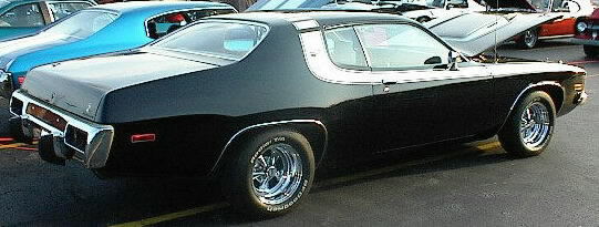

Hey Ron.
RH is a Sebring. Yes a 318 probably would of came with a 904. 340 and 360's got the 727. 8.25, 8.75, 9.25 and Dana all have 3" axle tubes so the shock plates interchange.
You'll burn up all of your brain cells trying to fugure out why people did what they did. Sounds like yours got mostly up-grades. Does it have the fender tag. If so post the codes and I'll de-code it for you.
