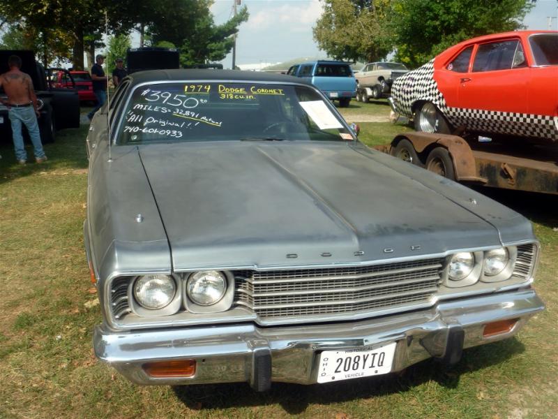

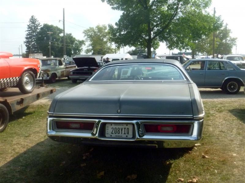

Here's a few shots of the car.
Looks like a neat car. Thanks for the link to the video. Didn't know that was on there. When I got my 74 Charger the switch was missing but I don't know what they did to rewire it. Nacho gave me some info on it sometime back because I wanted to keep the fasten seat belt light but have it turn off after a short while without enabling the system. First Chrysler came up with this, then the leanburn system then the K car , then they became Fiat.
