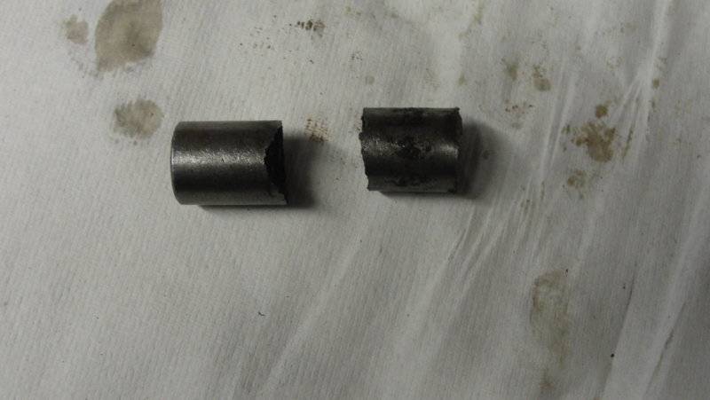

Wow what a mess turned out it was a steel bushing and too long also. Needed the press to get it out never broke one before was seriously worried about the housing shattering!
