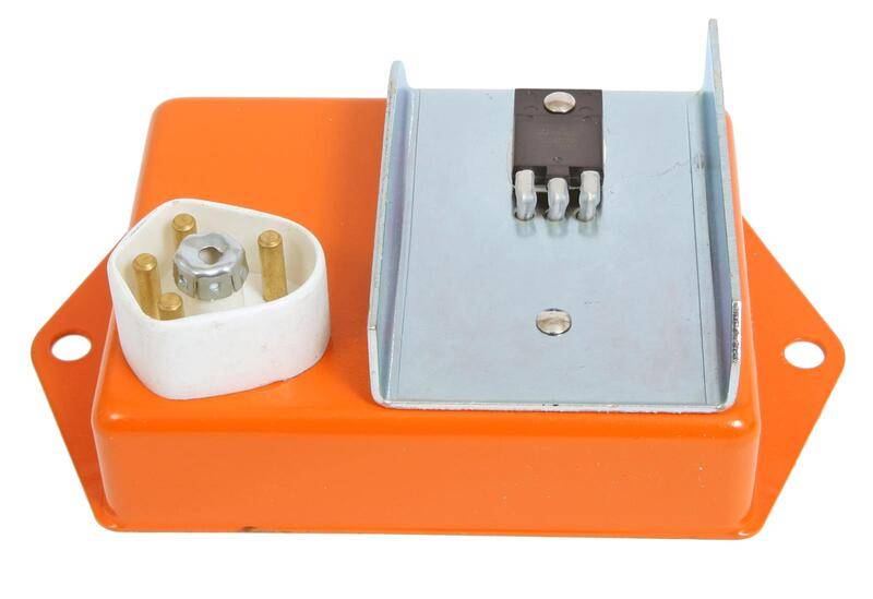

Anyways , remember when Summit Racing was selling an Ignition Module with the TO-220 Transistor mounted on the outside
They have since replaced it with a dummy cover
Summit Racing SUM-851021 Summit Racing™ Ignition Controllers for Mopar | Summit Racing

When I ripped apart the HI REV 7500 many years ago after it failed , it was made with the TO-220 Transistor and Dummy Cover
Yes the Transistor failed
