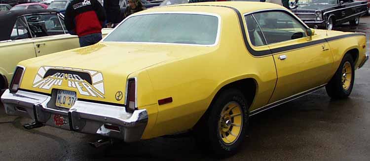

Here's one i had saved from the internet, i like this one to with the color scheme on it.. May as well share, I love the back end view on this.. wish i had a couple more for you guys, but, no go...

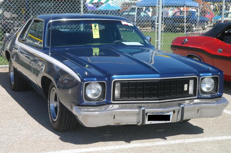

i went to a swap meet last summer and found this car in the car corral, its a 77 sport fury with a 383 from texas. i have close to 100 cars and sold and scrapped probably few thousand cars because i have been in the towing racket for over 20 years and i have never ever seen a car this clean!! its looks like it had a complete restoration but i think it just sat in a garage in texas most of its life?
after i bought it, i was scrolling threw different links about b-bodys and found my car on this website and a member that goes by the username "scratch" was the owner of this car and had it 4 sale with a 440 years ago and sold it later on with a 383?
my plan is to clone it into a 75 roadrunner because i have been looking for a 75 rr for 10 years or more and all i find is really really rough junk or show cars? ,,now IM LOOKIN FOR one of those junkers for A PARTS CAR to get the dash rr finish panel, nice door panels, correct bumpers, and few other odds n ends.
the BIG QUESTION i have is, i need to change the quarter glass and trim to make it correct to the 75 rr. ANYBODY KNOW IF THIS CAN BE CONVERTED FROM A 77 SPORT COUPE TO A 75 HARDTOP? mine has like a post with a fiberglass trim around it and the 75 has the entire window area opened with a stationary quarter glass?
im checking to see if my car came with the 20 gallon tank so that i can run the duals out the back because scratch had turn down tips before the 8 3/4 rearend that he must have swapped with the 8 1/4?
i really love this car cause i had one in high school and brings back fantastic memories from the 70's when i drove it to florida spring break from michigan, concerts in detroit, and a lot of other good times!!
Sparkknock for the rear quarter window you would need to cut the post and modified the opening to allow the window from the hard top to be mounted and also you would need to install the mounting bracket for the window unless you can find the optional roll down crank assembly.
Also you would need to replace (both side)the roof weather strip rubber and channel and install the belt line at the bottom of the opening/quarter panel.
If I where you I would leave it like that, it is way too much body work .
That's what I did on my car I left the fixed quarter window alone.
