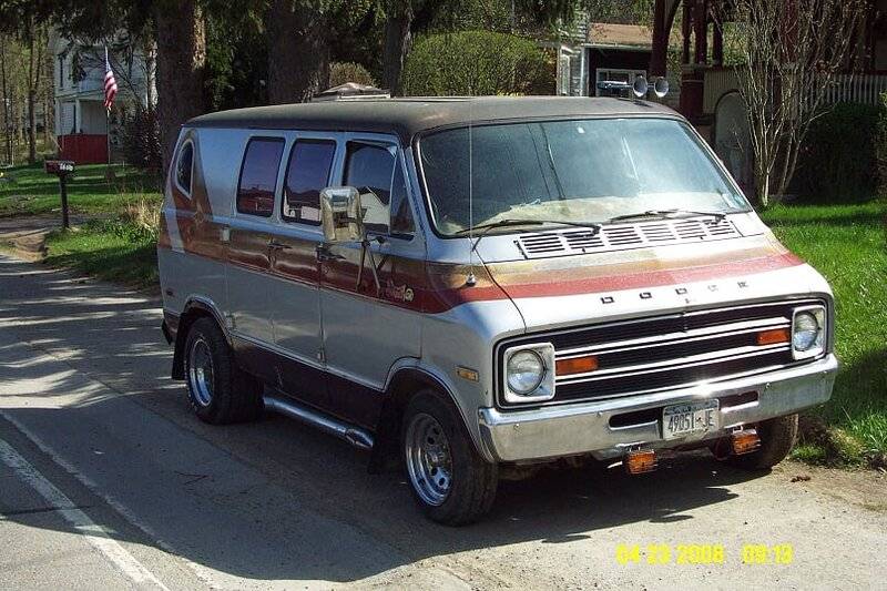

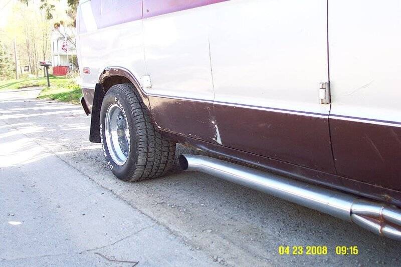

however,on a tradesman,you can fit some really nice meats under there.

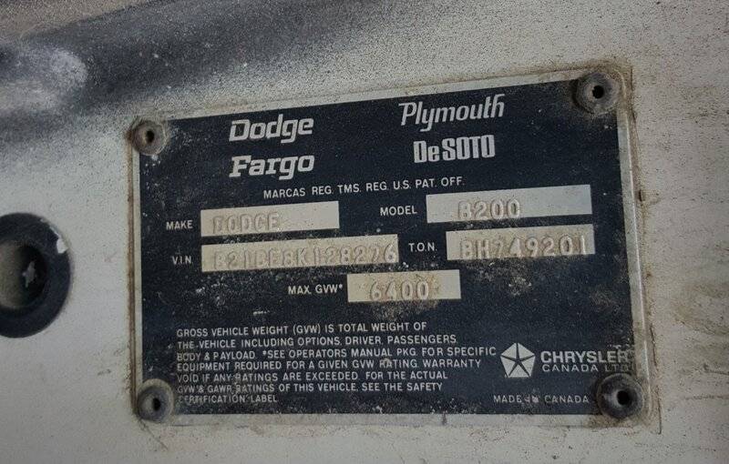

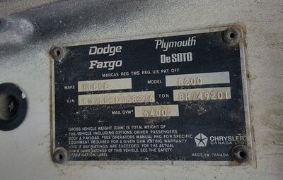

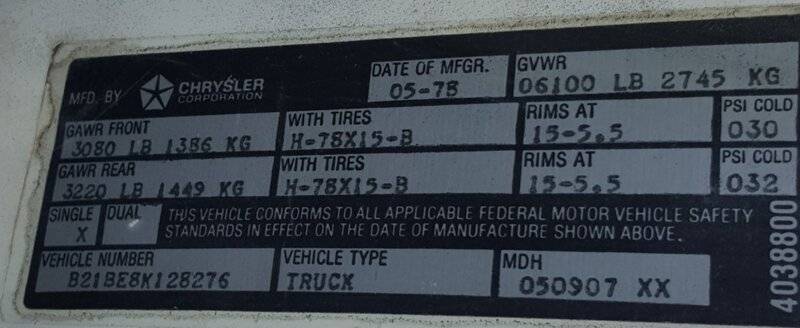

How about little more info like wheel base, Rim size that it on it now. Unless it was removed or painted over it has a tire size/load/gross vehicle weight sticker attached to the driver door post. If it is a conversion, the company that did the conversion was required to put a revised sticker/plate behind the driver or under the dash on the driver side.

i can barely make out the tag , E 78 x15
so im thinking its like prnd21 . H 78x 15
thanks guys
E78-15 P195/75R15
H78-15 P225/75R15
