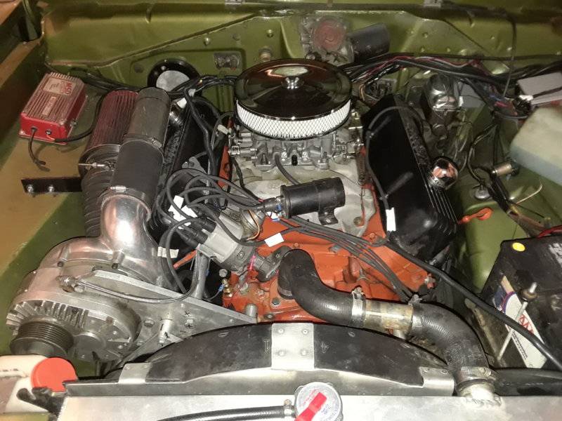

Funny you say that. I initially wanted to take this route for this year so I called Summit a couple days ago and asked for a cam recommendation. The guy said he couldn’t make a recommendation worth purchasing for a low compression 440. I told him I believe the engine is currently somewhere around 8.0:1 (google research based guess on my behalf). He said pistons pistons pistons, gotta get your compression up above all else.
IMO, sounds like a pretty smart SUMMIT guy to me ?
That said,
If it's a good running Engine ? IMO probably best just left "as is" and installed minus the lean burn obviously, versus, ANY Cam swap/bolt on parts contemplated on the low compression for bottom end characteristic.... just say'in.... the factory cam is probably as "good as it gets" down low ?
