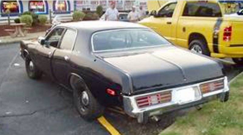

Yes that's the taillight style. My Monaco is white with the Brougham Package. For the most part it's in really good shape the vinyl top is good except right where it meat the trunk area, so i will need to have it redone. The interior is in excellent shape. Only some surface rust around the wheel wells and a bit under the hood. Right behind the Ignition Module it rusted out thanks to the ignition module "gooping" out (I'm assuming) so I need to patch that hole up. For it's age it's pretty nice for sure.
