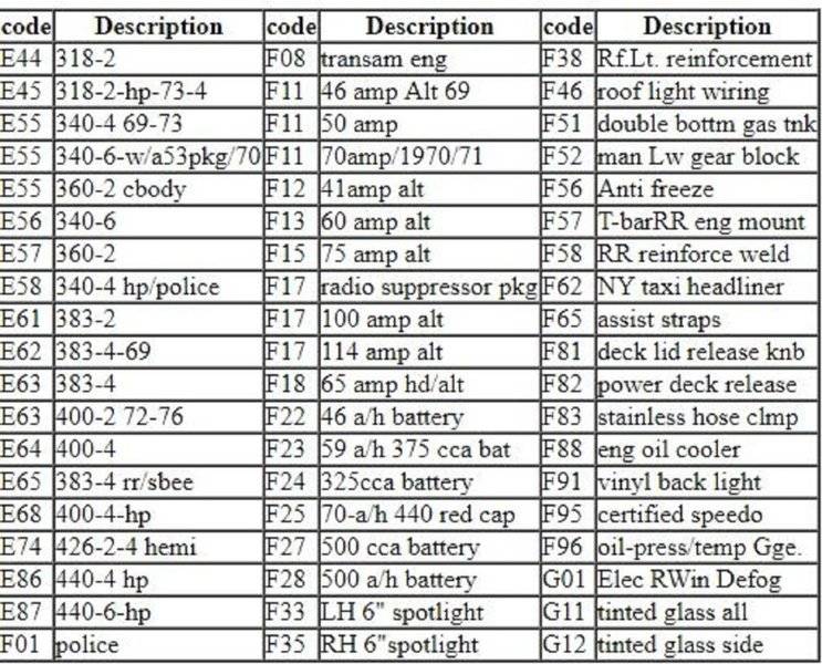

1978 Plymouth Fury Cop Car with A38 and E86
What do you guys think about the 1969 Dodge Polara Pursuit Cop Car with the big 440 with about 375hp.
It accelerates a lot faster and has also a way higher top speed than the 1978 police fury.
But i cant find a lot of info in the book about if it has a reinforced frame or stuff like that so i do not know how it will handle at high speeds in comparison.
Could you easily rebuild the 440 in the 78 fury to the 69 specs (375hp) or would you have to change/modify more than just the engine that the car could handle all that power? :)

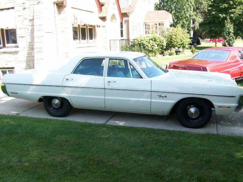

The 1969 Dodge Polara is the "golden grail" of Police cars. The second in my opinion is the 1970 Plymouth Fury "Pursuit" as is what I own below.
Honestly, any solid sedan can be upgraded to something on par or better than OE police. Firm Feel has torsion bars and sway bars for both 73+ B-body and a range of C-bodies. Other than some custom wiring for common accessories, police package cars were not much more than a taxi cab with performance and towing options. The idea was to build in power and reliability, but they also had to keep costs in line.

I see a lot of references out there to "extra welds" and a "reinforced frame" but do we have any proof that anything was actually different? My guess would be more welds or gussets on the K-member and shock/spring mounts. Maybe something similar to the torque boxes on hemi cars. The cast K-frame biscuits didn't even come out until the 80s.
You'll see references to the "special handling" tags that usually came on patrol cars, and in many cases that's all it means - special attention to assembly. The police steering boxes were double checked for tolerances and hand selected but they were just regular production boxes.
Chrysler was willing to bend over backwards for large departments with huge fleet orders like CHP who held their feet to the fire for custom packages. I believe there were also patrol and pursuit packages. In other words, a police car is not necessarily an A38 car, and all A38 cars are not equal to one another.
