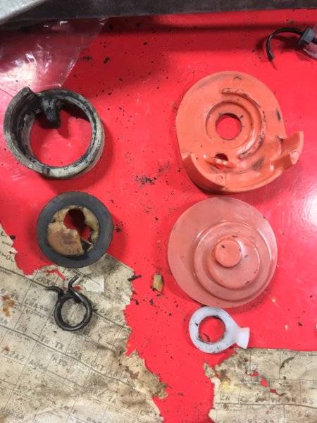

However, having ordered this kit off ebay:
https://rover.ebay.com/rover/0/0/0?m...2F172973859295
I feel like a bit of a fool, because I cannot figure out how anything in that kit helps me fix my wipers =/
Which is a bummer, because this is the rainy season here in the PNW!
I’'ve (hopefully) attached a picture of what I took off vs what I bought. Any help would be greatly appreciated!
That reproduction 'kit' looks like something your going to have to do a lot of modifications to, too make work.

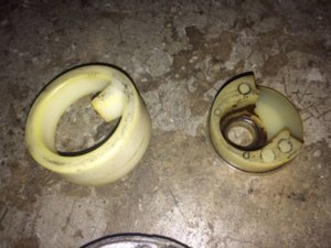

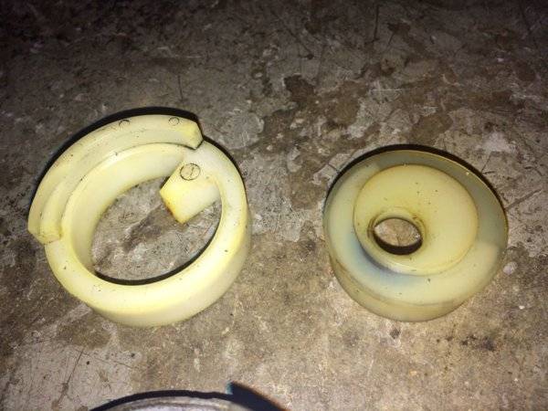

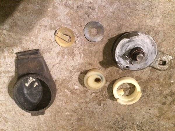

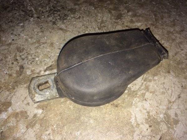

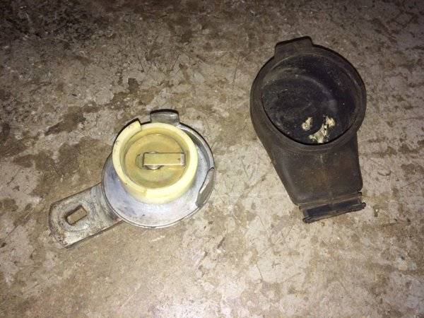

I hope the below pictures may help you do it... here is an original from a 74or75, hope it helps show how the original goes back together:

That does help me quite a bit! At least now I know that it appears to be an earlier style of wiper linkage. Thanks for the images Kernel, very useful. Also good to know I'm not crazy! All I'd read or seen elsewhere was that it should look like the kit.
