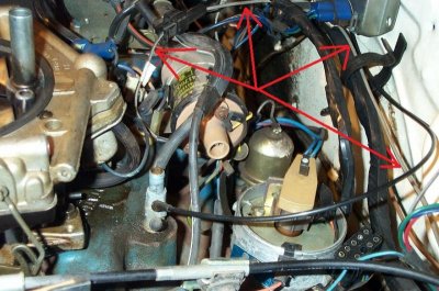

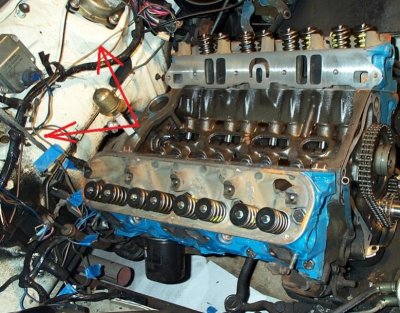

No way would I ever use an HEI ignition on a mopar but to each his own. By coincidence I worked on a buddy's '79 300 several months ago & too some pics. To best of my recollection the gray wire in the pics is the tach wire.

Thats a perfect pic. That'll help alot. I appreciate the help.
