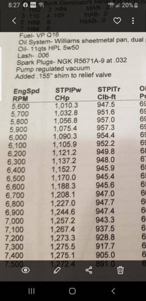

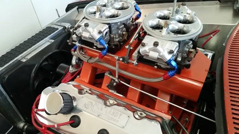

Assuming that was built for the three kits sitting on it, I would expect something similar. I’m guessing 7100 was where it nosed over. Probably still making power but on the decline. I’ve had several 4.500 stroke hemis pulling strong to 7500. Most street guys won’t want those kind of camshafts
Agree, camshaft, 4.80 lift ain’t gonna do it

Still just a little ole street car. The kits are excellent if I am late for work....

Piston speed with a 4.75" stroke along with the weight of a big bore Hemi piston at 8000+ is not for the faint of heart. High dollar pieces with scheduled replacement would be my thought. Or just bring a broom, floor dry and a dust pan. I hope it stays together and it's a rocket.

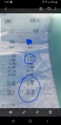

well mike , nice #'s for that dry air there . greatest of luck getting it down into those low 8's . but famoso folks preps the track well . of course infinity race park would have better air and make better power . raced them both . raced at sac's dragstrip , weather was so hot it was boiling the fuel in our carbs .
Just for the record....I have never forecasted LOW 8s.
I think with good air, perfect launch, everything being RIGHT I would HOPE of anything starting with an 8.
But...after that....I will set the ET Genie Restrictor plates, set the shift points, etc. for the car to run 9.60's which is the INDEX for C/Gas for the track that I run at (Famoso). The car will never go 8.60's so B/Gas is out of my reach.

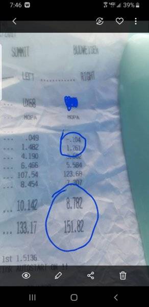

Low 1.20 60 foot. Just for cmparison.
This time slip is with 1200hp in July. 1.26 foot on the back tires. Hot as balls and I was very lean. Car has been 8.62@158mph
