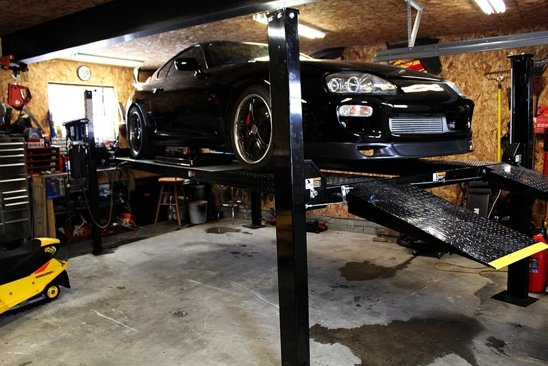

Pouring a slab in back of the house for a lift. Been watching craigs list and can get either 2 or 4 post used fairly readly for 1-2k . Leaning towards a two post, but guy has a four post for sale of 1,ooo right now. Is the jacking of the car on the lift to work on wheels/brakes that much of a pain, or is the roll on worth it hassle ?

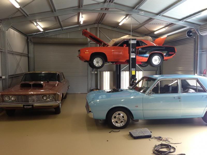

When I built my backyard shop in 2006, it was in the plan to eventually install a 2 post lift. I vaulted the ceiling to give me 13'6" of clearance at the ridge. Over the years since, I have delayed getting the lift for many reasons. Just last week I said F*** it and made the decision to do it.
This thing is fantastic. I've had it one week exactly and had 5 vehicles on it so far. I have a rolling oil drain and 2 tall jackstands for supporting mufflers and pipes. I see the 2 post as being far superior because it allows total freedom for any type of repair. Who wants to work around the drive on platforms that 4 post lifts use. Jacking up the car to get the tire off? Really? The 4 post units may be fine for exhaust, trans and other stuff but tire and brake, suspension work, etc require you to work around more obstacles.
