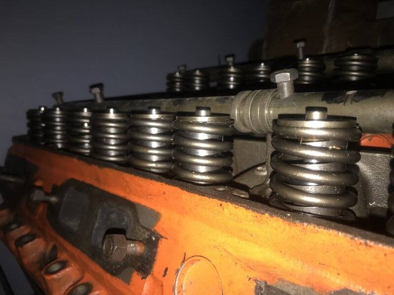

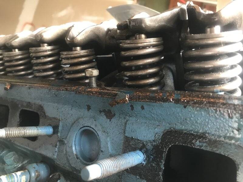

I recently bought a set of heads from another member here in a package deal
Both sets of heads appear to have been rebuilt and both are very clean heads. I was measuring the valve springs with my micrometer. And the set I recently got have bigger valve springs but dont know if they are stock. Looking at them vs my 516 heads they are larger in diameter also they have the inner dampner. I have to install a cam anyhow and was wondering which set of heads you guys would use? but I think the 346 heads and springs would be better for a better cam than stock.. Am I right or wrong? edited.... poster corrected me. They are not both closed chamber... Only the 516 heads.
346 heads springs measure 39.23
516 heads springs measure 35.72 mm
More like a inner damper, vs a true dual spring. Hard to fully tell without spring pressures and installed height. But definitely better than the small ones.
346 heads are closed chamber? Since when? I've never seen any.
My mistake... I, for some reason was thinking they were an earlier casting... They are 71 thru 73, I was thinking they were 67 but you are correct.
It's all about the spring pressures and what's required on your selected cam. Generally speaking the bigger springs will fit better with more than stock cams. I don't know which heads actually flow better, between the 346's and the 516's.

Yes those are just dampers, not inner springs...I'd want to test (or have tested) the spring pressures at the installed height you measured. I'd also want to know the coil bind height and clearance to the guides. Then see how that info jives with the recommendations for the cam you intend to use.
Im looking at the Summit K6400 to replace the cam that is in the 383.. It requires larger valve springs. Comp 911-16 plus retainers and keepers. The outer diameter of the springs on the 346 heads are really close to the outer diameter of the Comp springs.

Both sets of heads appear to be rebuilt. I was looking at a Summit K6400 cam and lifter set. But it says you need comp cams 911-16 springs. I was more curious about the existing valve spring size compared to the required valve springs of the summit cam.
The existing on the 516 heads are way smaller. The 346 heads are way bigger.. This is what got me to thinking they were after market valve springs. However, that may not be true if stock springs changed with each head year to year.

That's not a bad thing. If you can find the published specs for the Comp 911-16 springs, you could compare them to your damper springs if you had a spring tester. They look like factory HP springs to me, but age and time may have rendered them useless.
