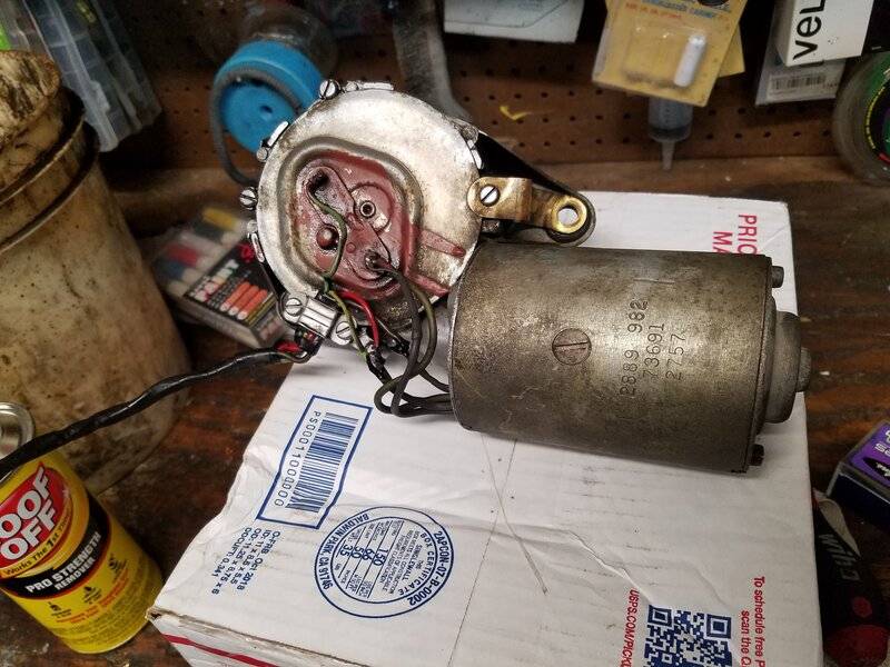

I have a 3 speed wiper switch in the dash of my project car but the only 3 speed wiper motors that I have all need work. I have a few 2 speed wiper motors though. Will they still work with the 3 speed switch in the dash?

My 3 speed motors have damaged wiring. I had a good one and actually sold it to a member here before I knew that I needed one.

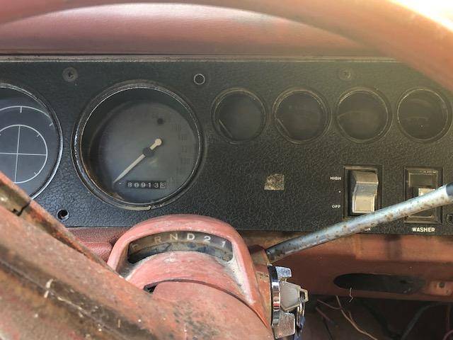

nothing unique about the wiper switch for chargers any 68-70 three speed Toggle switch will work
Your probably thinking headlight switches.
Okay, I just figured because it is a rocker switch and not a rotary knob, it might be specific to Chargers.
except A bodies, the rest of Mopars of those years are rocker kind switch for headlights and wipers.
( well E bodies got a mix of them ).
then B bodies returned to rotary knobs ( or pull out ) on 71.

My '70 had a 2 speed motor in it when I got it and everything else was original 3 speed. The motor will work, but I could never get it to park correctly. I ended up getting a 3 speed motor from Bruce Somer and everything works as it should now.
