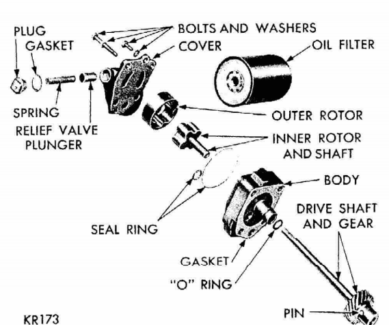

I installed a mechanical oil pressure gauge in the 65 GTO years ago because the factory gauge sucks and the 421 it turned out had a really bad crank bearing. At full operating temperature, the oil pressure would drop to 5 psi at 800 RPM idle speed, much lower than cold pressure. It was trying to tell me it had a bad bearing. I had a performance oil pump installed when we had it rebuilt, but I am cautious about "high volume" and especially "high pressure" oil pumps. High pressure can be moderated with the bypass pressure spring, but I'd rather get it close than have that spring bypassing too much. Too much pressure and it takes away from the "cushion" that oil provides bearing gaps. Too much volume could tend to drain the pan and push a lot of oil "up top".
