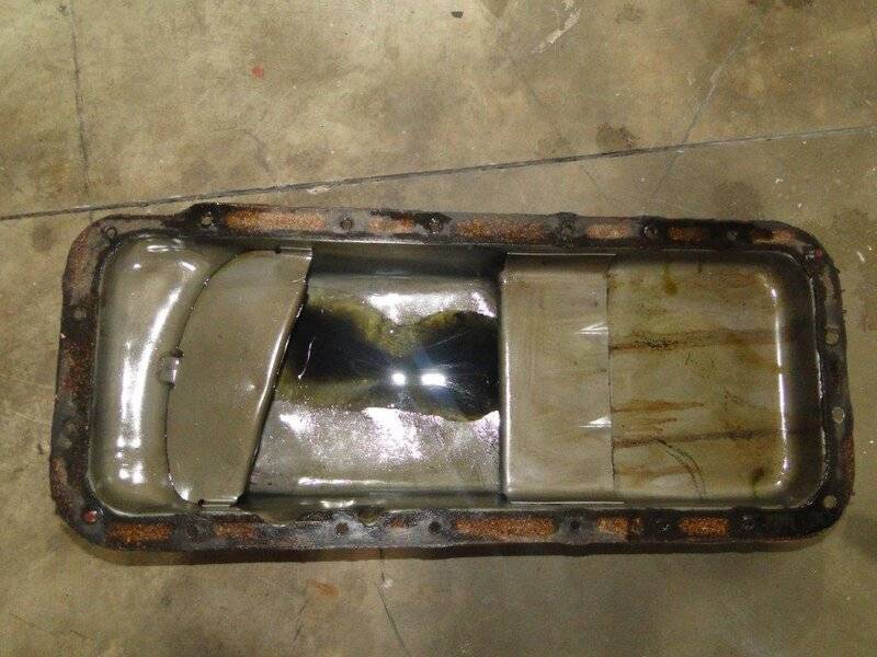

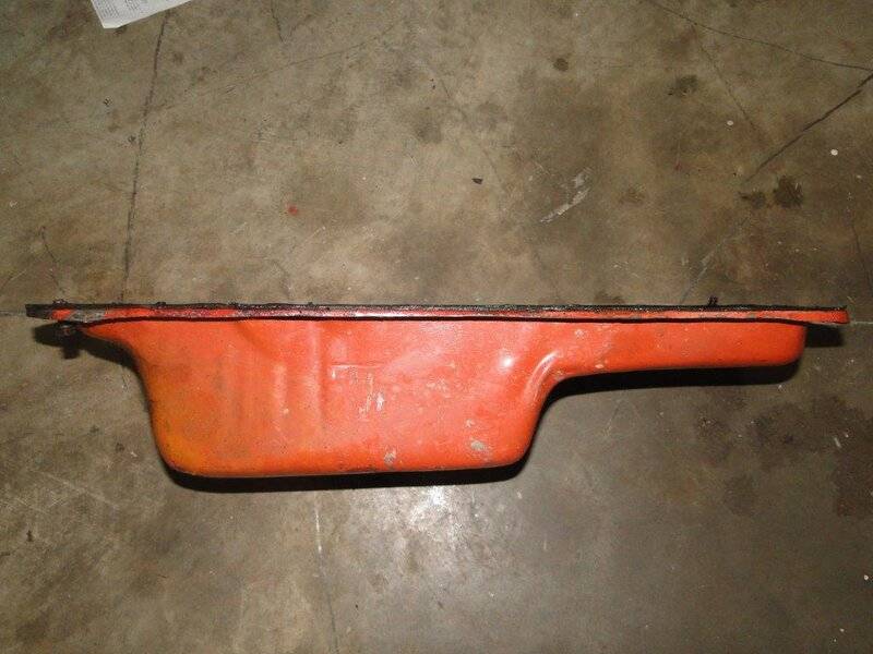

I thought the HP engines came with a 6qt pan. this is the pan off my 70HP engine. Holds 6qts.
Well all I know is the pan holds 6qts, (+ 1 in the filter) it is the original pan, the dip stick shows full with 6qts in the pan and 1 in the filter. With 6qts in the pan it is full to the bolt rail, I have measured it with the pan off. Hemi, 6 pack and magnum took the same pan in 70 and 71, as far as I know. However, I only put a little over 5 in the pan.
