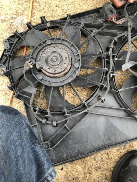

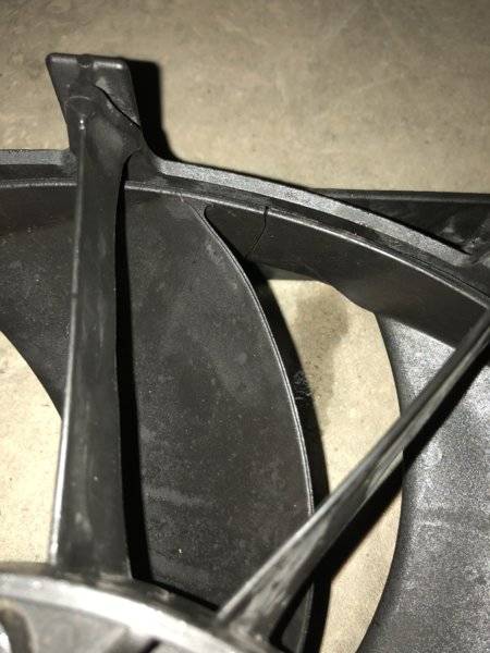

It's the fan motors, very common on the LX platform... pull the entire shroud assy out and inspect the fan blades closely, they crack and will bind on the shroud and cause the motors to fail.... oh yeah, the nuts holding the fan blades to the motors are reversed thread .. just a FYI !
Yup took the whole assembly out, ran power to the fans and nothing. Luckily autozone had them in stock so at least I can get to work tomorrow and recoup the 189 I spent on this crap.
Yup you got it, both fans cracked.
