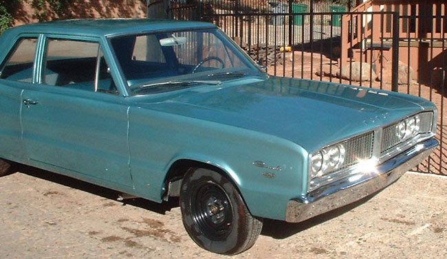

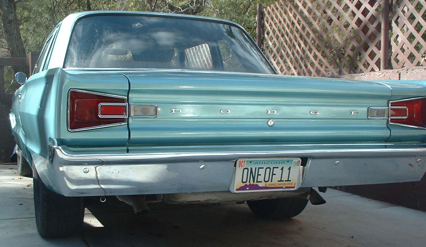

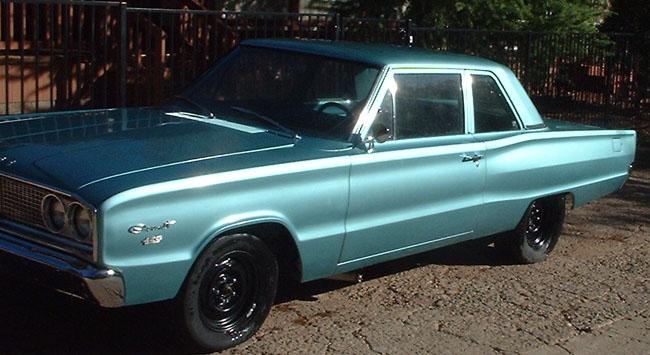

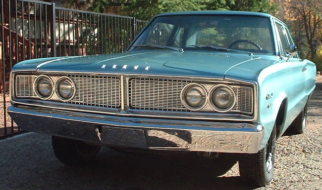

I have 205/70X14" tires on 5" wide wheels on the front of my 66 Hemi car and
255/60X15" drag radials on 7" wheels on the back. They don't look bulged to me. What do others think? The tires are wet in the pictures.
That sounds about right and they look good. I'd like to see a closeup of the rears though from rear to front.
