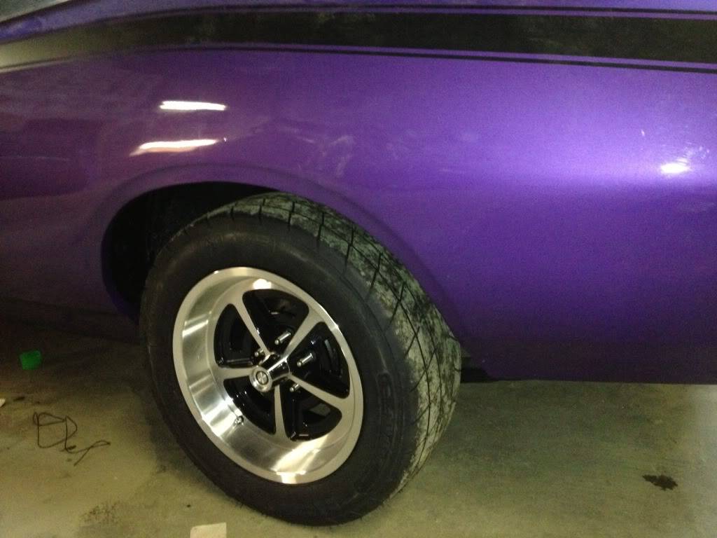

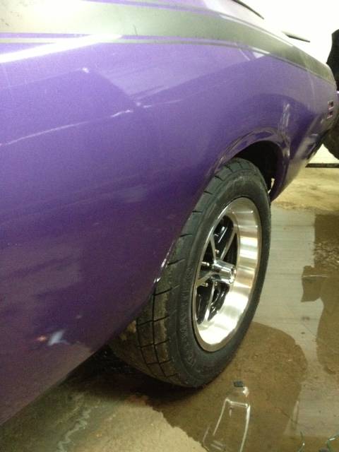

Anyway, here is a photo. What do you think? Fills the wheel well way better. Once the wheel molding is on it should look great!

Fit well and look great. 17x9 on all 4 corners. They nailed the BS with going with a 5". Do wish they were a 1/2" bigger so a guy could run a 295/45r17 on the back. I have since put a 275/50r17 M & H drag radial on the back since this photo. Fills the rear well up nice. 2" from the top of tire to the fender lip.

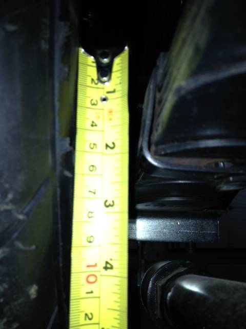

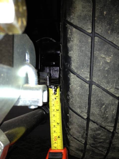

I agree with the 5 1/4" BS. I have 17x9 Magnums on my car with a 5" BS right now. I have a 275/50R 17 M&H Drag Radial mounted on them. Like most are finding, I have about a 1/4 - 3/8" more spring clearence on the P/S then the Drivers side. Here are a couple photos.
The tape is 7/8" thick. It is snug on the D/S so I am guessing it has about 13/16" space as it sits right now.
The P/S has a 7/8" tape width + about 1/4 - 3/8"

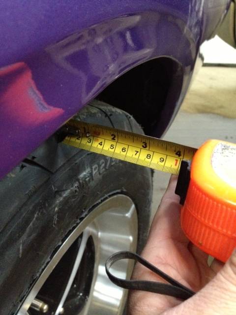

For awhile I was thinking about trying to fit a 305/45R18 into the well, but now that the 275/50R17 are on, I really like the stance. The 275/50R17 is a 27.8" tire which gives me 2" space to the top of the fender lip. A 305/45R18 is an inch taller. Not only will it be closer to the lip, I don't think it will fit inside? A 295/45R17 will probably just go with the perfect offset rim.
Would really love to fit a 295/45R17 in the well. They are a 27.2" tire, so only about 1/2" lower than the 275/50R17. Depending on tire bulge on a 295/45R17 on a 17x9.5 rim, I am guessing it would be an extra 1/4" bulge from a 275/50R17 on a 9", so that would take me to a 1/2 - 9/16" space left between the rim & spring on a 5" back space.
From the face of the tire that is on the car now, I am 2" to the outside of the fender lip, so a 9.5" rim with 5" BS takes me to 1.5" to the outside of the fender lip. Considering an extra 1/4" of bulge on the tire takes me to 1 1/4 - 1" from the outside of the lip. Technically still in the well, but barely.
From the measuring I have done I too am finding the 275 is easy to fit in the back of a 71-74 Charger, But a 295 wide tire is a challenge. What do you guys think?
Looks good to me Wookie, It appears that you could go a little bit more if you wanted to, but they do look good! That look from behind they look super good, Love those rims.
