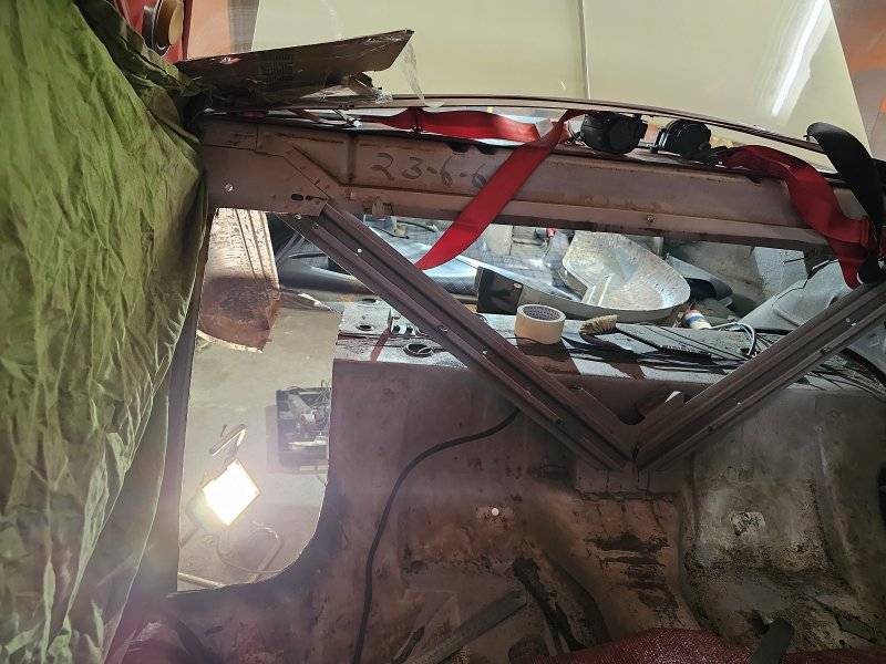

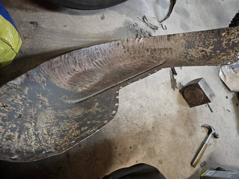

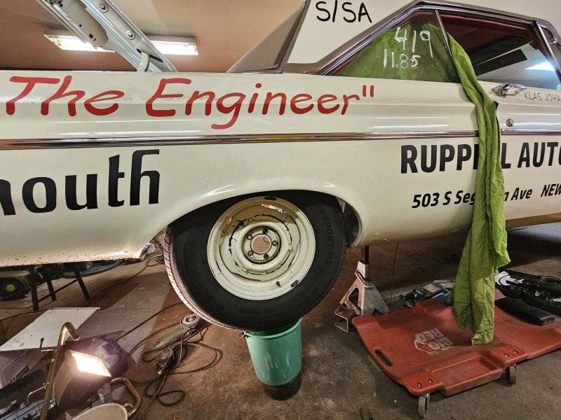

I'm in the process of mini tubbing/ relocate springs on my 64 Belvedere.

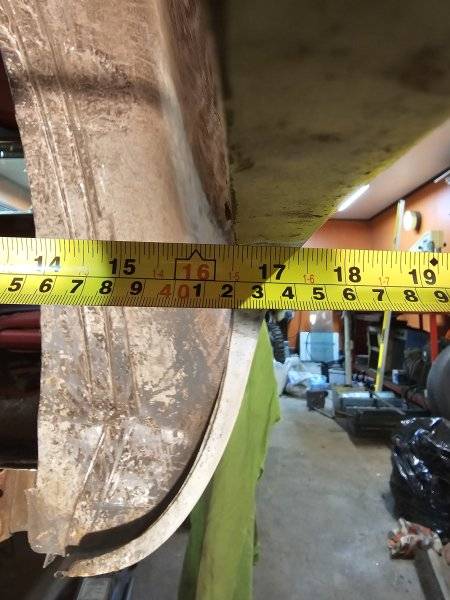

Will have 16.5" from frame to fender lip. I can cut down the lip some if needed for even more clearance.
